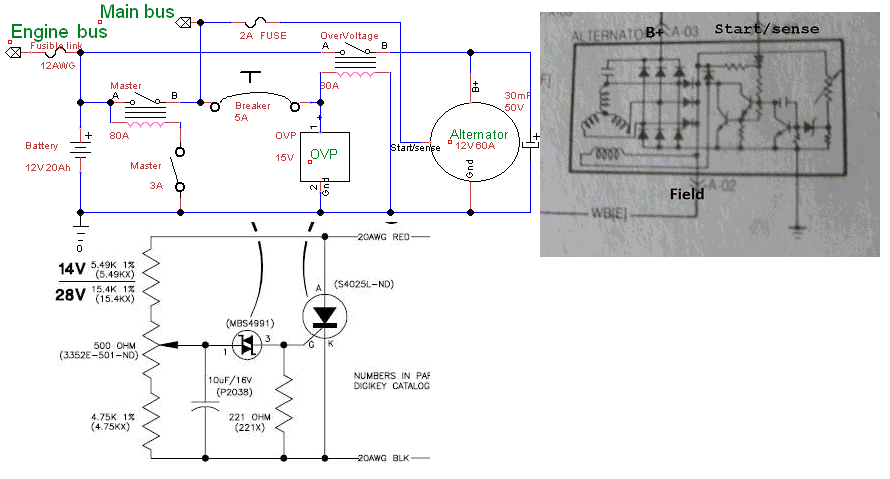

I just spotted the terrible error in the the Z-24 diagram in the
Adapting_IR_Alternators_to_Aircraft.pdf document I have!
It shows the alternator F-terminal connected to overvoltage relay power
which is pulled to  ground when OVP activates.
In case of a nuisance trip you now have killed the field in the
alternator, and if you have a battery failed open, there is no battery
to provide startup voltage to the alternator after resetting the
breaker. That's what took my plane down.
If F is the internal regulator startup/sense terminal it should be
connected to B+. (Any Alternator Warning relay terminal -- typically
connected to positive side of field winding -- can be left unused.)
I would also recommend a 30,000uF or bigger capacitor from B+ to ground.
That should  provide sufficiently low ripple and noise power for the
alternator and its internal regulator with no (failed open or
disconnected) battery.
Finn

Attached is what I think is the correct way to overvoltage protect an
automotive  internally regulated alternator with  a relay in the B+ lead.
Finn

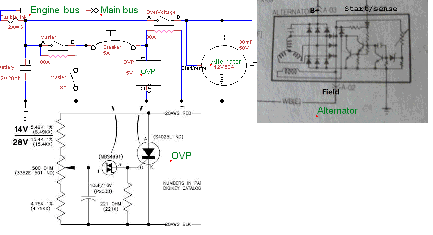

PostPosted: Thu Jan 02, 2025 6:48 pm    Post subject: OVP relay in B+ lead bad idea -- corrected Reply with quote
Fixed attachment!
Finn
