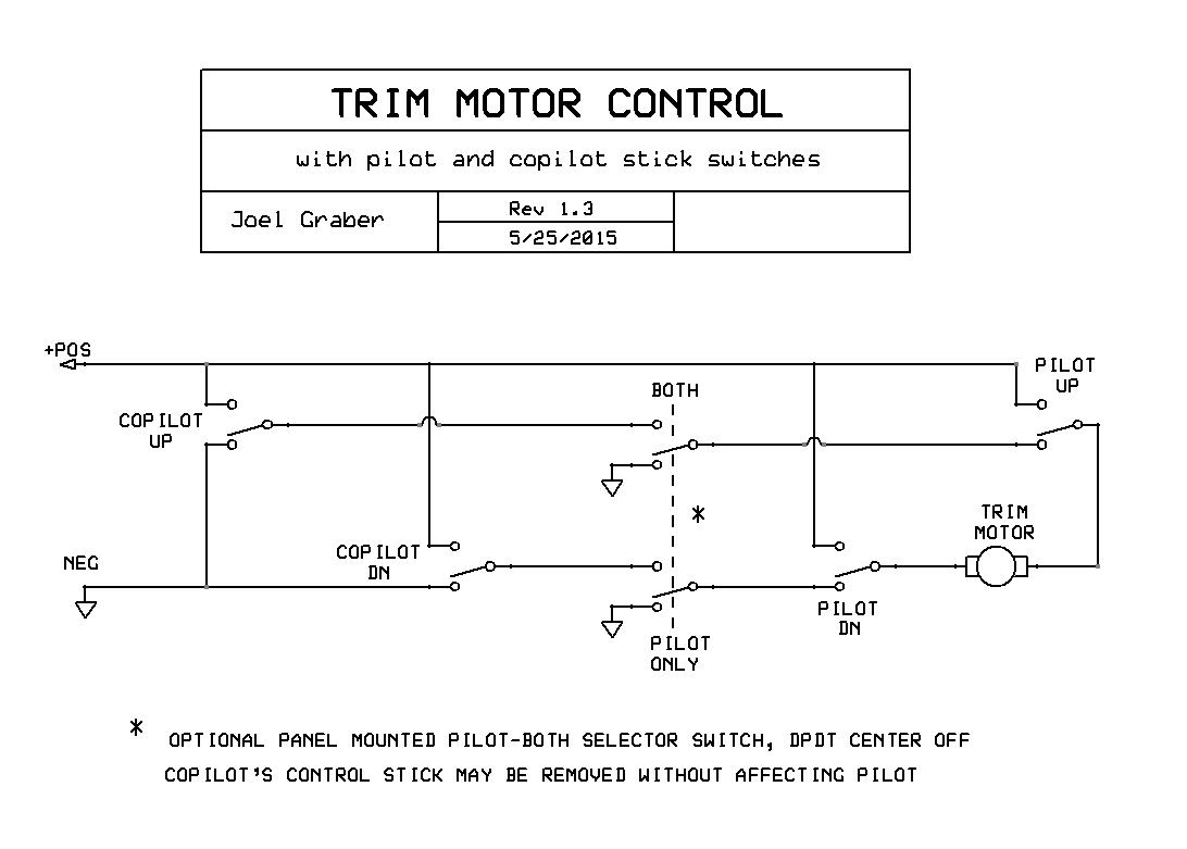

Here is another way to override copilot's trim switches.
 Filesize:  80.73 KB
 Viewed:  449347 Time(s)
