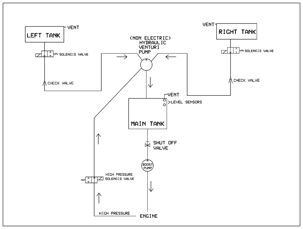

Pete, I made a diagram of the Viper Jet fuel system based on my interpretation
of your description. It is unlikely that I got it right. Please make corrections.
Understanding how the system is supposed to work is the first step in designing
the electrical fuel controls.

Now I see it
Pretty close. The main tank is vented. The fuel lines from the wing tanks go to the pump. The pump is not electrical, it is a jet pump that uses high pressure fuel from the engine to create low pressure to draw fuel from the wings to the main tank. In your diagram the fuel would flow from the wings through the pump to the main tank. Fuel also flows from the engine in your diagram through the solenoid (when open) and pump to the tank. The fuel supply to the engine isn’t depicted and doesn’t need to be. There are also one way check valves between the wing tank solenoids and the pump so fuel can only come out of the wing tanks. The main tank has a high and low level sensor to signal when the valves should open or close. The goal is to always keep the main tank full until the wings are empty
Pete

I redrew the hydraulic circuit in my post above. The new version is based on a sketch that Pete emailed to me.
Is it accurate Pete? Is it pretty? Smile

Yes it is much prettier than my hand sketch and accurate. Only comment is it’s a fuel circuit, not hydraulic. When/if this is done I need something similar to control the hydraulics, so this is like some foreshadowing

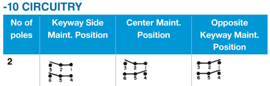

For those following along, the Honeywell 2TL1-10 (MS27407-4) is a DPDT ON-ON-ON switch. See the attached screen-grab from the datasheet for its functional drawing.
Pete, do you have a diagram that shows how this system was supposed to be wired? It would be helpful to see how the switches would have interacted with the PLC and the solenoids, and where 28V and ground enter the circuit.

OK, the 2TL1-1 is a standard DPDT ON-OFF-ON switch.
