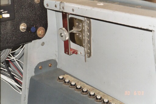

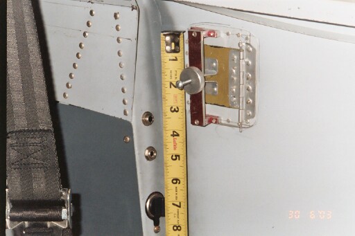

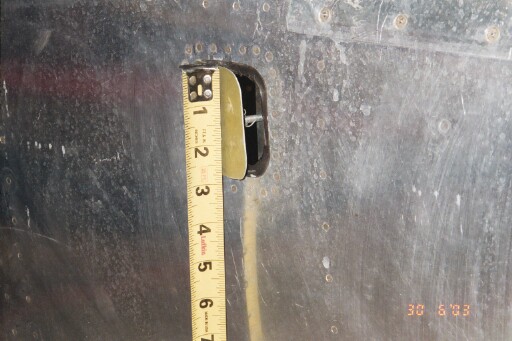

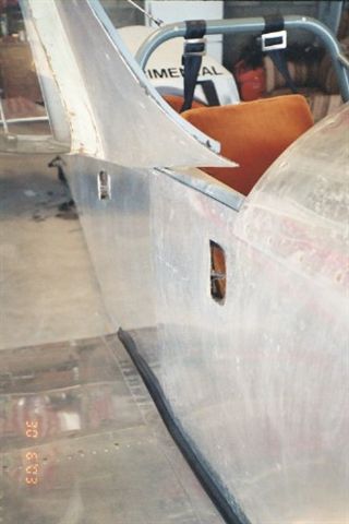

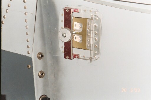

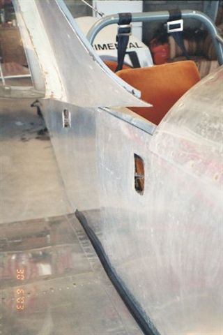

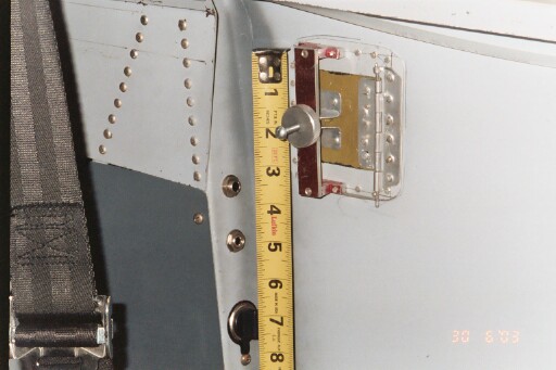

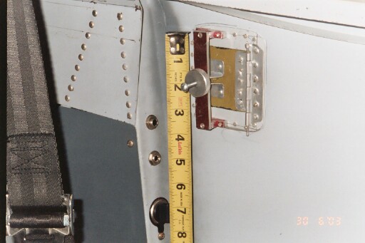

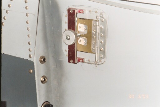

Please note the date of original post. I'm no longer with earthlink and the
plane has been painted to flown to OSH. Used KISS method, sealed by
spreading sealant (we used black RTV & trimmed any excess once the door was
closed ), covering with saran wrap, closing to door & allowed to dry. Open &
remove plastic. No air leaks when closed at 200 kts plus.
This is posted on the RV list. KABONG (GBA & GWB) HRII 300 hrs.
