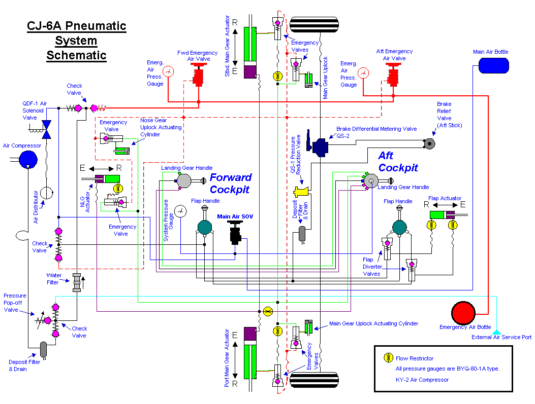

Jim - for those of us without immediate access to the manual, what/where is the "QS-1" valve?
Thanks, Dave
In a message dated 11/28/2006 4:57:36 PM Pacific Standard Time, cjpilot710(at)aol.com writes:
Well I found out what the problem was.  The QS-1 valve was the culprit. It was full of rust and corruption.  I started the search by pressurizing the system with nitrogen to replenish the system tank since it was to low for a start. In doing so I could hear air escaping from somewhere in the belly. I traced it to the QS-1. I replaced it with one I already had on the shelf. Bingo problem solved. Test flight with some acro thrown in, showed all back to "normal".
I can replace the rubber seal in the valve and the steel springs inside and she'll be put on the parts shelf, well oiled and greased in a baggy.
ggg6(at)att.net
PostPosted: Tue Nov 28, 2006 7:59 pm    Post subject: Hmmmmmmmmm That ain't right. Reply with quote
I'am not sure wheather this schmatic of the air system will come thur on the site, but will try to forward it. It shows what and where the QS-1 Valve is in the Sys.... Gary
-------------- Original message from KingCJ6(at)aol.com: --------------
Thanks, Dave
 Filesize:  411.07 KB
 Viewed:  335 Time(s)
dave(at)davelaird.com
PostPosted: Tue Nov 28, 2006 8:54 pm    Post subject: Hmmmmmmmmm That ain't right. Reply with quote
On the CJ6 the QS-1 is the brake pressure reducing valve... pull the
brake handle and the cable feeds down under the front cockpit and
pulls a lever attached to this valve... the air comes out of this and
goes to the QS-2 differential braking valve. The position of the
rudder pedals moves an arm on this valve which allows air to go to
the left, both, or right brakes. Center the Pedals: air equally to
both brakes. Full Left Pedal: air only to left brake, etc.
