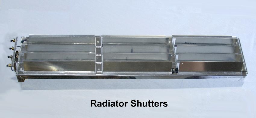

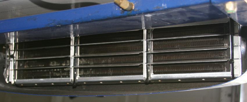

PostPosted: Sun Dec 10, 2006 11:41 am    Post subject: Cabin Heater Questions Reply with quote
There is a start up company - HighWing LLC (Yes I am involved) that has a
radiator shutter kit for the Skystar supplied radiator for the 912 series
engines. It is an easy assembly and attached to the radiator with Nylon Tie
wraps. It requires a Button Lock dash control like the A-700 from ACS for
operation.
For other radiators, an exact dimensional drawing with location of the inlet
and outlet accurately depicted and we will make up jigs from that.
Attached - two photos. one installed in a Speedster radiator shroud and one
uninstalled.
If anyone is interested drop an off list note.
Lowell
 Filesize:  30.14 KB
 Viewed:  550 Time(s)
 Filesize:  38.56 KB
 Viewed:  568 Time(s)

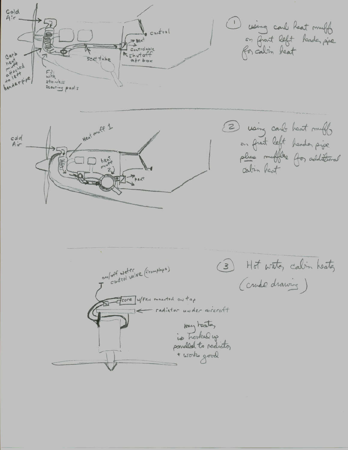

PostPosted: Mon Dec 11, 2006 10:14 am    Post subject: Cabin Heater Questions Reply with quote
Nick,
In response to your earlier question about cabin heat, I installed a heater
core with a fan controlled by an automotive water shutoff valve in my 912ul
Model IV-1200. It works good as long as you keep your CHT's around 200
degrees, and keep the cabin well sealed. I don't have any photos convenient
but would be happy to take some if you'd like to see more of the
installation.
BUT if it were me, I'd utilize the carb heat muff before going through all
the bother with the heater core setup. It would be easier to do, less
expensive, lighter, and most likely provide even better heat than the heater
core setup. But I doubt using the carb heat system as it is (by letting the
hot air just rise up into a scat tube that would go to the cabin) would
provide very little heat. So here's what I think one needs to do to create a
very good heat system using just the existing carb heat muff;
I haven't done it yet on my airplane (I too have the removed carb heat setup
you do), but my plan is to use the old carb heat muff off the left front
exhaust header by attaching a scat tube to the top of it and then attaching
it near the gearbox inside the cowl so it gets a direct prop blast of
pressurized air. I'd then fabricate from a piece of aluminum or stainless a
four or five inch extension to the bottom of the muff, with a round outlet
on it to attach a piece of scat tubing that will then go to a controllable
firewall heater air valve. End result, a simple, light, inexpensive cabin
heat system that is controllable from the instrument panel. I'm confident
this setup will provide very good heat, as a Rans I fly has a similar setup
and it gets very warm. The exhaust temps coming right off that cylinder
head should be nice and toasty. Plus, with no welds anywhere in the area,
there is much less risk of exhaust fumes in the cabin. BTW, don't forget to
stuff the heat muff with some good stainless or brass scouring pads. They
retain heat and slow down the air movement, providing significantly more
heat than a system without any.

heat muff scat tube to that. Then run two short scat tubes to airboxes on
the firewall (so you now have two controllable heat vents. Your wife will
love it....) You will probably want to play with scouring pad use in this
system, as you shouldn't slow down the air so much that you cause excessive
exhaust pipe temps. (I'm going to guess you could just remove the pads from
the header pipe muff, but keeping them in the muffler muff. You will
essentially have preheated air entering the muffler, and being heated again
before entering the cabin). This double heat muff system should allow you
to fly in the coldest of conditions.
And then if all else fails, install that heater core system as well for a
"three heat system". But bear in mind, should your heater ever fail in a
full heat mode, you had better be ready to fly home naked Smile You will
have one hot cabin!
I've attached a quick drawing I did that should make this all more
understandable, hopefully.
