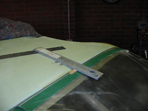

For those who have not put there front window in I just did ours and wasn't happy with just putting a weight on the window to hold in place so if you have a look at pic I used a bit of scrap bar with a bolt threw it into where the support arm goes. Just tighten up and its done !!
