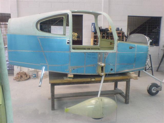

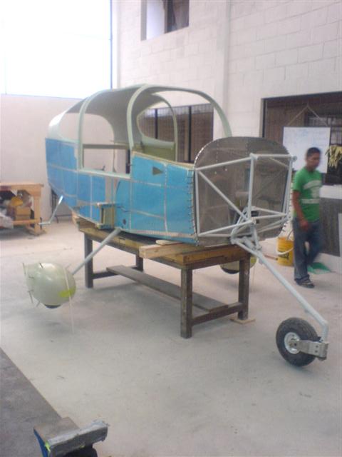

Posted: Thu Dec 14, 2006 7:22 pm Post subject: Deperately seeking opinions - (well maybe urgently seeking |
IMHO the attached pictures show an ideal time/place/way to install the
fairings. Any time after this could work also, but it is nice to get them
out of the way early.
Do not archive.
Jesse Saint
I-TEC, Inc.
jesse(at)itecusa.org
www.itecusa.org
W: 352-465-4545
C: 352-427-0285
