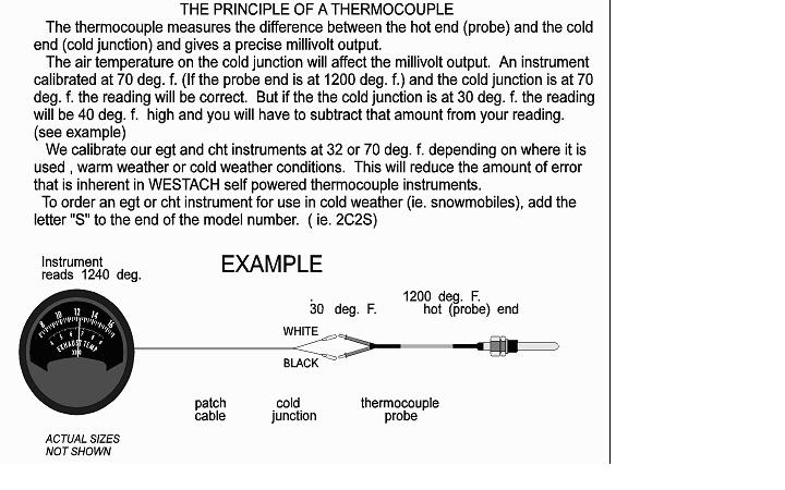

The thing is that, the EGT system is measuring differential temperature.
Ok., the system that is used for measuring the exhaust gas temperature is
measuring temperature difference, NOT absolute temperature!!
Well, it is measuring the temperature difference between the
cockpit(inside cockpit temperature -NOT the OAT!) and the EGT probe
temperature.
But you'll know, the temperature in the cockpit may change -then your EGT
reading change too!!!
To know your correct EGT temperature (at the probe) it important to know
the cockpit temperature.
So now, I'm wondering Smile how many of you are using a true cockpit
thermometer?
Some of you might have the double temperature meter, that measure the
inside and outside temperature (with ice warning) for cars?
This is indeed a good idea (if you checked that the readings are correct)
as this can be used to calculate your "true" EGT.
The ting is that, your EGT system is calibrated at a known temperature!
Do you know this temperature for your instrument???
Now, think about this "calibration temperature" as a line across a
standard mercury meter scale, if your cockpit temperature is above this
line -your meter is reading to low!
This is because the meter (and the calibration point) is moving towards
the EGT probe temperature, see less difference I.E. reading to low.
The other way around, no cockpit heater (or a poor heater), I'm trying to
say that the cockpit temperature is below the "calibration value". In
this case, the indicated value will show to high, so we think that we are
boosting the red line. But indeed we should subtract the "absolute" value
of the reading BELOW the "calibration value" line.
In this latter case, our reading will be to high.
Ok., to summarize; in the winter time our reading will be to high, -and in
the summer time our reading will be to low, IF OUR COCKPIT TEMPERATURE
DIFFER/VARY WITH SEASONS FROM THE INSTRUMENTS CALIBRATION TEMPERATURE.
If you have a temperature controlled “de luxe” heater that can maintain,
say 23 deg. Celsius in the cockpit -everything become so much more
simple. Smile Smile
(I'll add a little bit more about this later.)

torgemor(at)online.no
PostPosted: Fri Dec 29, 2006 11:17 am    Post subject: Possible overheating and EGT question Reply with quote
You're correct Lowell, the cold junction is at the connection point of the
thermocouple harness. This is the "harness" that's connected directly to
the probe.
Normally, this two wires "Chromel and Alumel" is connected directly to the
indicator, this is why "the cold junction point" normally is referred to
the indicator location.
However, now an then wires need to be changed or modified for various
reasons. In your case, the thermocouple harness is to short. Normally we
would order an extended thermocouple. Often we find them in three
different lengths, but all of them has the same resistance, if you measure
them with the EGT probe immersed into a mixture of ice and water. If this
mixture is stirred, it's the lab. definition of zero degrees Celsius, the
freezing point. In fact folk, we're using this method to really calibrate
accurate those big jet engines EGT systems, and here we're talking about a
different of one tent of a degree!!
The connection method Westberg (or nowadays Westach) use is the so called
"uncertain method", which is good enough for the kind of use they mention!
I've attached a little picture from their web site, that's show this
method very well. Anyway, the cold junction temperature Westach use is 70
Deg. F., or 21.11 Deg Celsius. This is their way of philosophy, cause most
operation take place in this temperature area, so the end result "might"
not be to far away if the cold junction is ignored.
The other calibration point they are using is the zero degrees Celsius
reference, this is in fact the standard cold junction reference point, did
you know that the "Chromel/Alumel" give 0 VDC at this temperature??
Handy, isn’t?
Now back to your problem, the short thermocouple harness. Do you know the
actual resistance for his cable(this value is often stamped on the
instrument side)?
If those two wires is to be extended, you'll have to make sure that the
total resistance do not increase to much, as this will create an
additional error and the indicator will give to low reading when temp is
high.
The standard cable (thermocouple) Westach are using is 2.4 Ohm. This total
value is not to be altered as this will ruin the system accuracy. There is
several solutions to this, the first and simplest is to use another probe
option with extended leads.
There's two more method’s, "the preferred" Chromel/Alumel connection
method -and a simple extension using "the preferred" connection.
Then to the link, Westach is here:
http://www.westach.com/
On the left side under INFORMATION, select Hardcopy Catalog then roll down
and select page 53; Then you'll see (the original picture)"THE PRINCIPLE
OF A THERMOCOUPLE"
So if you got one of those indicators, you'll find all the information
needed here for all of their instruments -also connection sheets etc.
The important thing is the resistance in the "added wires" -and that the
two spliced wires is in the same "temperature environment" that you can
measure all the time!
Remember, the temperature here (at the cold junction point) decide your
corrected reading -your true EGT temp.
Later on I'll make a few drawings how we use to connect the cold junction
by using the "preferred method". Maybe also a little about how we can
manipulate the system and still have a correct reading.
Torgeir.
PostPosted: Fri Dec 29, 2006 12:23 pm    Post subject: Possible overheating and EGT question Reply with quote
Hi Lynn,
Yes, you're right by now you've probably been reading my post to Lowell
about this.
Funny that you mention the EIS, I'm a little curious about this system,
cause such a modern design should have an automatic cold junction
compensation system built in, I.E. the system measure the actual
instrument temperature and then correct the reading so you'll always be
reading the true EGT (well, -the temp at the probe).
If you are using this system, it could be interesting to know their cold
junction reference.
Yes, the principle is just the same, except that they're using an
amplifier and an analog to digital converter -vola..
Torgeir

actual instrument temperature and then correct the reading so
you'll always be reading the true EGT (well, -the temp at the probe).
cold junction reference.
Torgeir
On Fri, 29 Dec 2006 16:56:27 +0100, Lynn Matteson
<lynnmatt(at)jps.net> wrote:
> Lowell-
> I think what Torgeir said was that the EGT reading is a
> differential between the probe and the cockpit temp. My
> understanding of my EIS is that it references the unit
> temperature...that is, the temp of the EIS "unit" itself, and any
> other temp that you are monitoring. If Torgeir was not talking
> about the EIS unit, this comment may not apply.
> Lynn
> On Dec 29, 2006, at 10:29 AM, Lowell Fitt wrote:
>> <lcfitt(at)sbcglobal.net>
>> Torgeir,
>> I have understood, as you say, that the the EGT probe is
>> measuring a differential temperature between the probe and the
>> end of the metal shielded lead. My lead does not terminate in
>> the cockpit, although there is sufficient length to do so. The
>> leads on the Lancair IV I am helping with are too short to enter
>> the cockpit We coiled the leads aft of the first two cylinders
>> so the leads terminate in the same relative location, but they
>> are in the engine compartment. These airplanes are built to fly
>> in the flight levels so positioning the terminals above the
>> baffling would give the reference temps a great fluctuation.
>> They are positioned below the baffles of necessity due to their
>> length.

Torgeir-
I just read the manual re the "unit temperature"...to quote:
"This function is displayed on the hourmeter page, and shows the
internal temperature of the instrument. It is used by the instrument
for cold-junction compensation of the EGTs and CHTs. It is also
useful for estimating the cabin temperature, as it tends to stabilize
at about 30-35 degrees F above the ambient temperature."
It goes on to mention that it (the unit temperature) can be used to
check for excessive instrument (the EIS itself) heat, but that's not
pertinent to this discussion.
Lynn
On Dec 30, 2006, at 9:00 AM, Noel Loveys wrote:
Enough to say Lynn your EIS is probably a darn sight more accurate
than my
EGT. As long as you didn't cut any wires or use speaker zip wire
in your
installation.
Noel

PostPosted: Sat Dec 30, 2006 7:51 am    Post subject: Possible overheating and EGT question Reply with quote
The probe wires is what I was referring to not being cut. The probes are
usually available with several different length harnesses. All of which
will have identical internal resistances.
As you wrote, your EIS has a second probe built in, physically close to the
cold junction that monitors the temp of that junction and automatically
makes your compensation corrections for you. That's the best. Except of
course if you loose your EIS at which time you will have more worries than
an EGT a couple of degrees too high.
Some other instruments will have a little bi-metallic spring, similar to
what is found in a thermostat, in the meter that will make adjustments for
the temperature of the cold junction. Sort of second best. In the event of
a power out you won't lose your EGT but the bi-metallic spring can after a
time lose its calibration.
My EGT doesn't have any compensation built in but the documentation says it
is calibrated for 20C (68F) Since my cockpit temps seldom if ever get above
68F the instrument is usable. Even if the cockpit temps went up to 80F the
accuracy of reading the meter because of parallax etc is probably close to
the 12F the meter will be reading too low.
In flight my EGTs show an almost even 1100F my plugs say they are getting
good mixture so I can now depend ( to an extent ) on my EGT gauge. I will
probably continue to check my plugs every 5-10 hr.
I got into a discussion with a gentleman on another group last year about
the use of extending probe harness with copper speaker wire. He said the
two extra junctions that were created would balance each other out and the
instrument would still be accurate. Actually there would be four junctions
created as the connectors actually on the instrument are chromel and alumel.
He considered a few feet of copper wire to have a resistance of 0 so it
wouldn't throw off his EGT. In fact the way he uses his EGTs just to follow
temperature trends it probably works for him.
Noel
