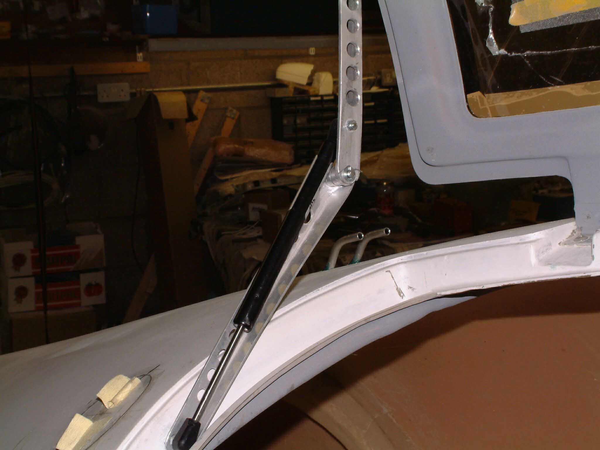

Good day chaps.
Anyone have any tips on fixings for the 'reversed' gas strut.
Glue and rivit some an ali angle to the door frame?
Any special place?
Any traps to fall into?
Would this require mod action via pfa?

the best way is to use Ted Dexter's mod, he mounts the gas strut into a
folding strut so that none of the strut pressure acts on the door. Its
the most elegant solution for this problem, Andy Draper had it on his
desk for ages but never got a round tuit unfortunately.

my mistake, Ted Gladstone is the guy and his strut mod isn't on the web
site. I've attached it but it may not get thru
Mike
the best way is to use Ted Gladstone's mod, he mounts the gas strut into
a folding strut so that none of the strut pressure acts on the door. Its

Hi! Mike
Suggest you do the mod. that Ted .Gladstone did, c/w all the aluminium angle it is really a masterpiece and eliminates all distortion loads on the doors.
