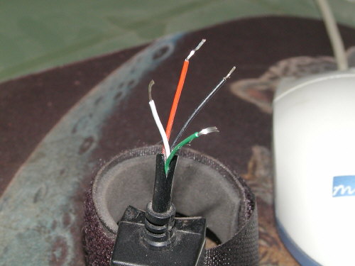

I am normally on the Kolb list and one of the guys there suggested that I could find the answer to one of my problems here. I have a grip on my stick that has five buttons, one of which is supposed to be a push to talk button. However it only has two connections on it. The other buttons control my EIS. I had thought that a I-Com push to talk switch was merely a momentary switch. When I cut into the wire I find a red, green, white and black wire. The red and green show continuity when the button is pushed. The white and black also are a closed circuit. I really don't want to screw things up, can anybody enlighten me as to the best way to hook this up.

Correct. ALL PTT buttons are normally open, momentary
operation.
| Quote: | When I cut into the wire I find a red, green, white and black wire. The
Then use these two wires.
