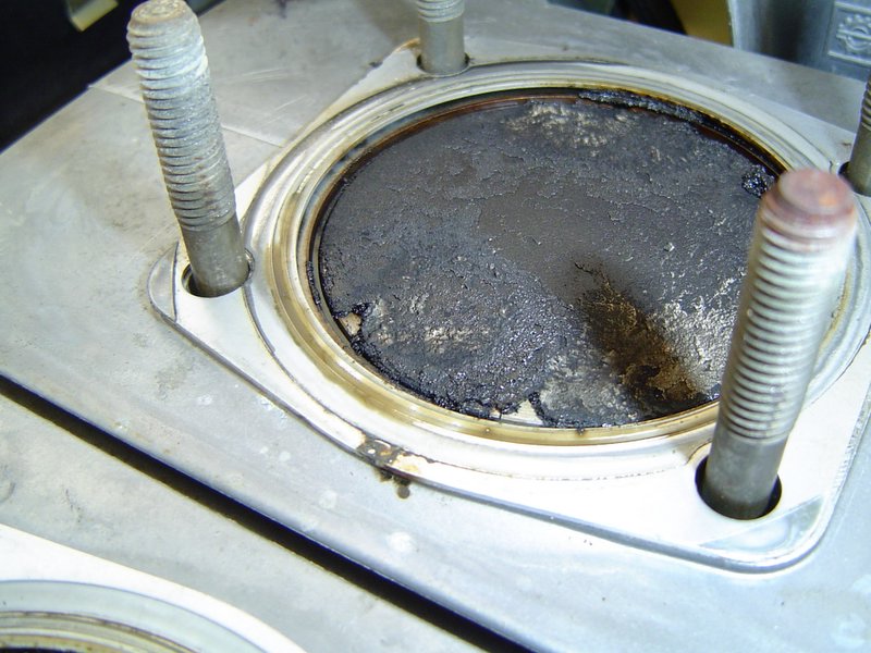

I had 147 hours on the 447 and it had a good amount of carbon. I'm glad I decided to decarbon it. The rings were free and It would have been OK for a while longer. I run Pennsoil for air cooled engines at 50:1 premix.
After I had decarboned it I noticed some oil dripping from the front of the engine and I had to remove the engine and replace the oil seals. I did this at about 160 hours.
Here is how it looked before I did any decarboning. Looking at the rings from the exhaust port always looks good. If it looks bad then it is probably really, really, bad.
