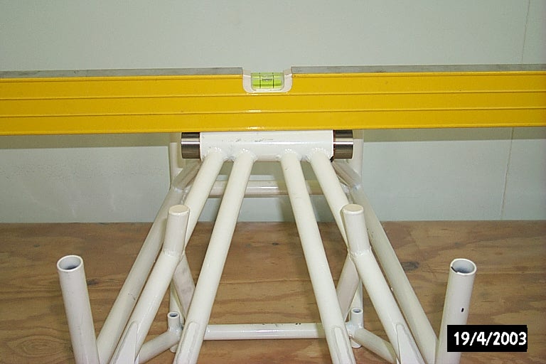

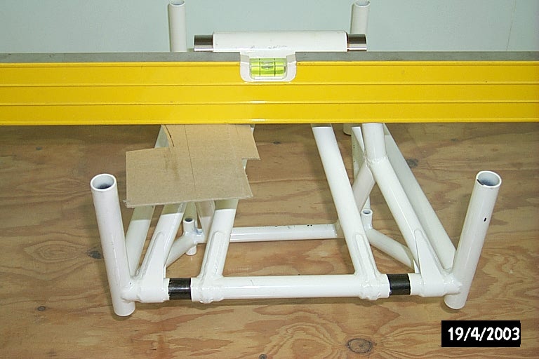

hurstkr(at)redzone.com.au
PostPosted: Mon Mar 05, 2007 3:16 am    Post subject: Re. mono gear collapse Reply with quote
Fellow Europaphiles (Mono believers only)
I think I made the list aware of this some time back but just in case I didn't . . .
Take a look at the attached photos which are self explanatory and note the packing which was necessary on one of the stops.
Of three undercarriage frames I have checked, all have had this problem. I therefore suspect that YOURS might be like it too.
IOW, one stop is shorter than the other and when the LG08's are pinned to the shaft, although they both touch their respective stops at the same time, they (the LG08's) are not in the same plane. One is more over-centre than the other. I'll leave it as an exercise to work out what this could cause!
Cheers
Kingsley in Oz
 Filesize:  91.28 KB
 Viewed:  257 Time(s)
 Filesize:  81.83 KB
 Viewed:  264 Time(s)
jodel(at)nildram.co.uk
PostPosted: Mon Mar 05, 2007 9:30 am    Post subject: Re. mono gear collapse Reply with quote
Kingsley,
In those photos the mount is resting on the engine mounting points. These are offset toward the starboard side of the aircraft. I suspect that the “error” that you found is supposed to be there.
Simon
G-BZTN
PostPosted: Mon Mar 05, 2007 4:51 pm    Post subject: Re. mono gear collapse Reply with quote
Simon,
You must compare BOTH photos. The frame was in the same position on the bench when both were taken.
The frame was resting on the engine mounts but the purpose of photos was to show the relationship between the stops and the housing for the shaft that ties the LG08 's. A line drawn between the two stops was not parallel to the axis of the shaft. Believe me, the stops were NOT correct.
Anyway, my frame is a Classic one and as such does not have offset engine mounts AFAIK.
Kingsley
PostPosted: Tue Mar 06, 2007 10:34 am    Post subject: Re. mono gear collapse Reply with quote
Sorry! I see what you are getting at now.
Simon

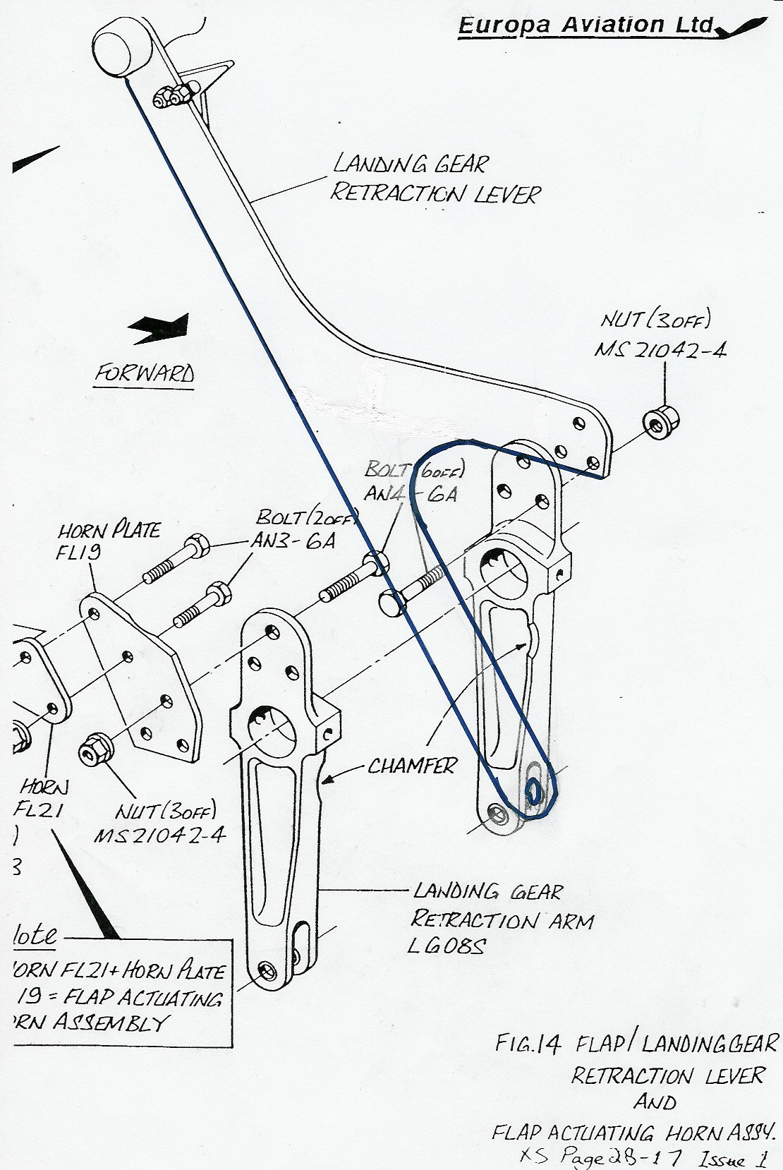

Hi Kingsley and all,
I made the same measurements as you did with the same results.
In my logbook I entered the "optional" mod 51 strut application on februari 2001 two years after publication. But I did it my way.
Page two of the mod begins: The strut will not be absolutely straight but its sideways flexibility will allow this. I thought not to allow any flexibility at all. Neither the bending of the lower part of the landing gear lever could ever receive my green to go. Last but not least the moment arm to tranfer the moving forces to the three AN4 bolts seemed to me to long even with the proposed strut. The mecanism has also to work when the supporting bungee eventualy fails; and then friction forces are great.
In attachment a raw outline of my strut mod. Of the same alloy I made it in one flat plane. The problems that further occured were easily solved. a) The shaft moved 1,5 cm outwards to accept the lever without bending. In the cockpit module this was a problem for the incurved swell for big thighs. But since I never had them big, at my age I could easily make the choice and modified the cockpit module, not yet installed. By eliminating the curve I had a beautifull flat surface as well horizontal as vertical and believe me certainly as strong as it was before, because the way it was made was for people who never will look how it was done.
b) I remarked by visiting other builders and Cranfield and Kemble that for those building like the book; the handle to operate the lever was only at the left side (sorry trikers, whe are mono's). In my mod I have sufficient space left to operate the landing gear lever in the same vertical plane without forcing a torsion on the lever and without amputating my little finger.
c) At the lowest end I changed the pivot pin by one 4 mm longer without problem.
d) Finally I was lucky to notice that by fixing the three bolts, the lever gave a light pressure inside to facilitate the locking in the gates of the guide plate.
By trial and error I made the stuts equal to stop the overcenter and avoided hammersledge from metal to metal. I remeber that I was laying under my beauty pushing up and down the gear many, many times. Believe me there was no sexual meaning at all but I got a real satisfaction when I knew it would perform when I would be the pilot. Meanwhile I have only 25 hours self done from the beginning ( I am flying since 1959) and now waiting for the mod 72 and inspection at the same time.
Kingsley, I much appreciate your observations,and forgive me if I did violence to your beautiful language, I am Flemish.
