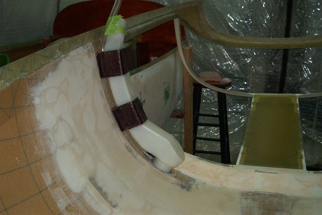

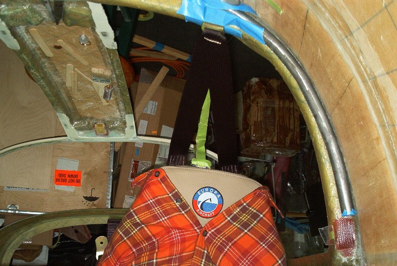

Got a few pics of shoulder harness attachments.
4130 chrome moly tube with solid 4130 TIGed inserts
Rollbar coated with hot linseed oil inside then sealed
Rollbar was scuffed and wrapped like a racing bikes ram horn handlebars
with 1 layer of glass and redux
3 UNI wrapped up and over rollbar back onto itself
Fairing behing rollbar is combo of Q-Cel and Flox with wire poly tube in
there for good measure
3 BID between Uni for download help out
Rollbar ready to install was a tad under 3 pounds, unfortunate I did not
weigh top of fuse before and after, but all said and done 7 to 10 pounds??
