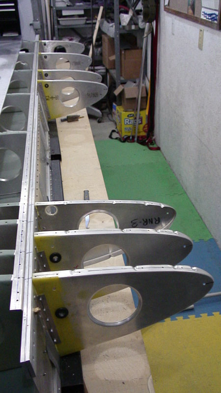

To install the 15 gallon tanks you move NR 4 outboard and have to cut off the portruding "L" for the original location of NR 4.

I'm building from component kits and I ordered the 15 gallon tanks with the wings. NR4 is not moved during assembly in my kit, it is left out completely. It wasn't even included in the kit. Instructions said to cut the protruding part of the "L" for NR4 off flush with the remaining portion. They stressed that I not drill the rivets out of the spar.
Also I have seen several 601 wings built with two nose ribs turned web to web and less than an inch apart. One of those I think was originally the NR4 (inboard) but the second one (outboard) is not in my kit either and there is no provision for it. It is not shown in my plans.

I'm building from plans. I'll probably replace NR4 with a hat. and move NR4 outboard of the new tank. That being the case, what's the width of your 15 gallon tank? I take it it's just a stretched version of the 12 gallon tank. I'll make a 15 gallon tank based on the 12 gallon profile and just add some length to it. That way I'll know where to move NR4 to on mine when I reposition it.

The factory installed "L" for NR4 using the factory 15 gal fuel tank is at STA 1770.

Cool thanks. I think I'll make the 15 gallon tank instead. I'll move that L and install a new hat stiffener where it was originally located. They didn't move any other ribs did they. I guess that NR doesn't line up with any of the rear ribs.
What's the actually length of your tank? I would assume that no other ribs moved so it should be just a matter of subtracting NR station at 1770 minus the next inboard NR for a rough length of the tank, no? The reason I'm asking for the length of the tank (or at leat the distance between the ribs it sit inside of) is because in case there were any of changes of rib locations, at least I'll no the length of the tank for it to be 15 gallons vs 12 gallons, assuming the side profile is the same, which I don't see any reason why it wouldn't be.

The 15 gallon tank measures 1270 mm end to end. The "L" for the repositioned NR #4 is moved 260 mm outboard of where the "L" for the 12 gallon tanks was installed. There is no rear rib behind it. The factory built spars do not extend the aluminum bar that runs on the front of the spar top and bottom out to the new position of NR #4 - there is a hat stiffener between the old and new positions of NR#4 for a total of three behind the tank. There are 7 nose ribs in all.
I've attached a pix taken of the bottom of the wing looking out from the wing root.
Tim

ashontz
Joined: 27 Dec 2006 Posts: 723
Posted: Fri Mar 16, 2007 3:08 pm Post subject: Re: 601XL fuel tank baffles |
Thanks for the info. That's all I needed.
