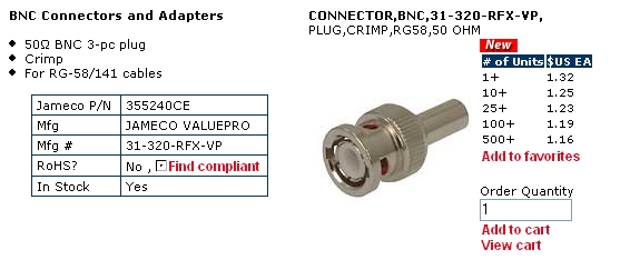

Hmmm . . . Did you get the connectors and tool from different
sources? One of my suppliers was Jameco but they don't stock
the import connector I used to sell any more but they do
offer name-brand connectors. Suggest you try
https://www.jameco.com/Jameco/Products/ProdDS/355240.pdf
It's their stock# 355240
