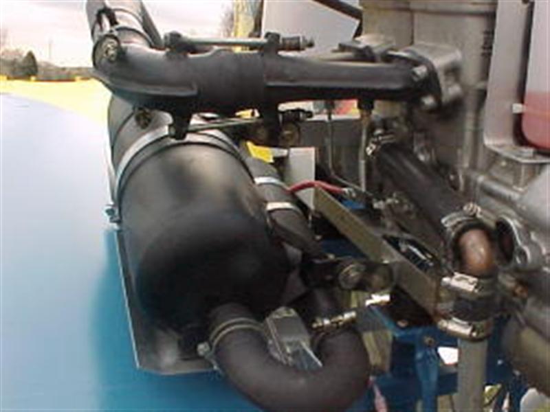

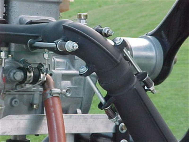

I made my own. Here are the ones on the MKIII and on the FSII. With 5/16" bolts, it will take a while to wear through them...
