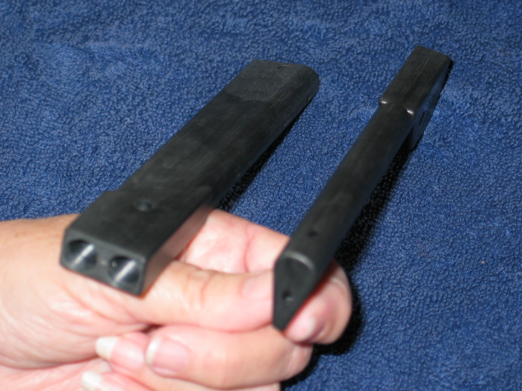

Hi John,
I took a look at your LRI probe picture and noticed it is significantly different from the one that I made. I did mine according to the drawing I got online. It seems you have rounded and angled the edges differently.
I wonder, have you done any testing on this new probe design? Does it work the same as the original design? Does it work better? What happens when you put your plane in a forward slip with this new design?
Paul
XL fuselage

This is certainly not rocket science. No sense spending a hundred years
figuring it out to the the last angstrom.
Just a mere differential pressure sensor. A REALLY simple way to test it
would be mount it on something (a Burt Rutan wind tunnel for example (a car)). with a pressure gauge (airspeed indicator, etc) on each port hop in,
stick it out the window and simply confirm a reasonable pressure
differential across say 0-30 degrees or so. That would certainly be
enough to tell you whether or not it will work.
Correct
Yep, not new really, been around 30 yrs that I know of.
Never flew the original.
Of COURSE it does Truthfully ,I have no clue.
Indicates normally , only testing I've done so far is on my Champ, it has been flown on several ultralights as well.
John
