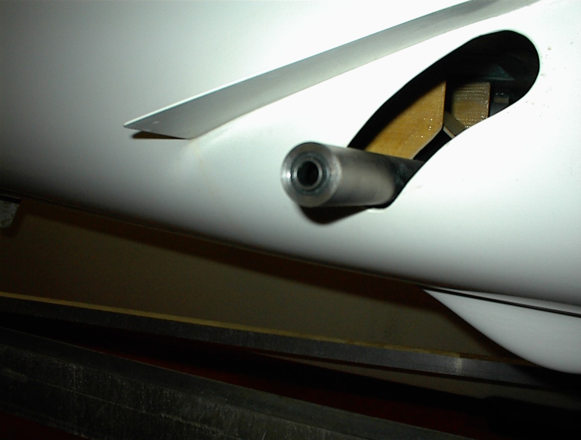

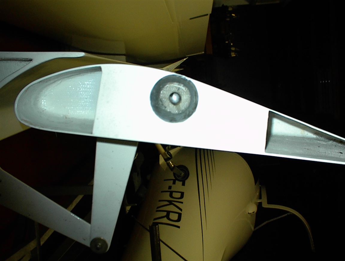

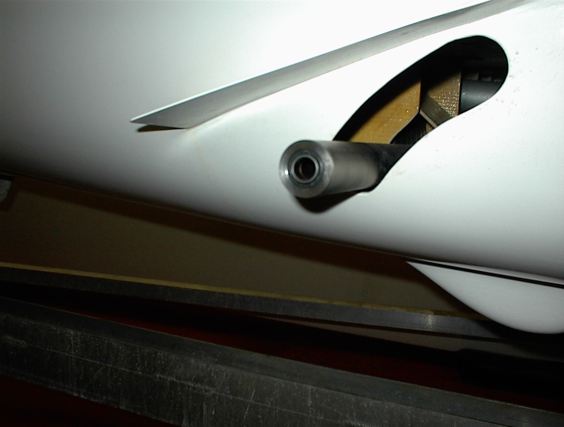

pictures I made. Number one and two are with extreme left and extreme right
position. You barely can see the difference. So this means that the movement
is restricted. Number three shows the pin in the flap. You will notice that
I made a cone to guide the rod with the bearing to the pin and no rigging
problems.
Karel Vranken, # 447 F-PKRL
