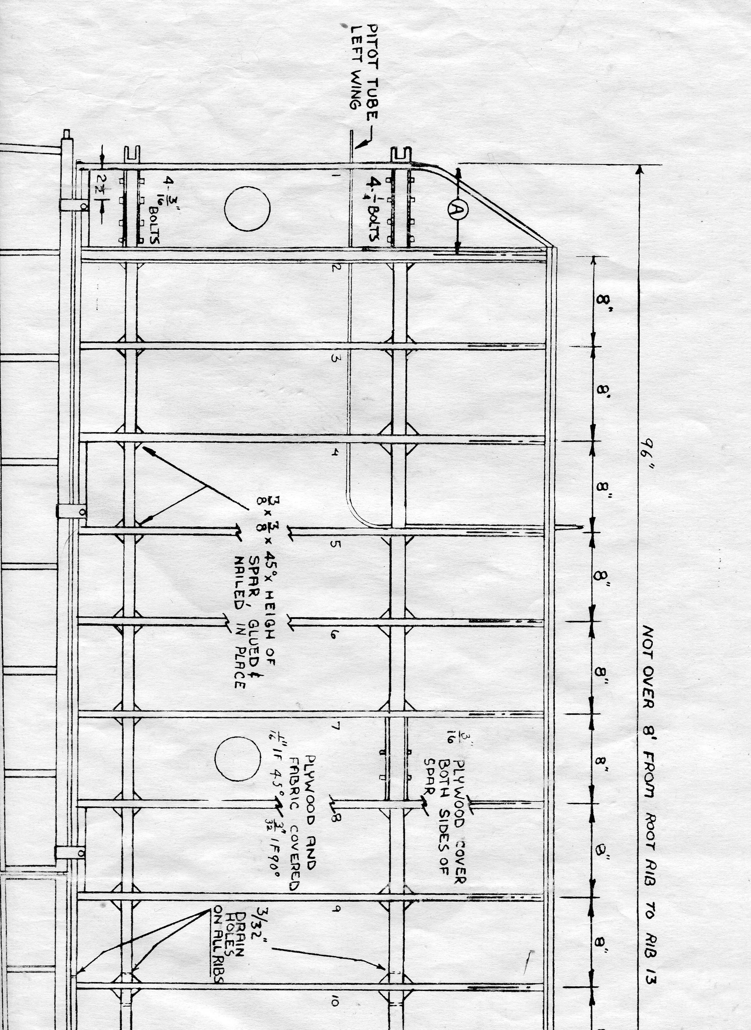

Has anyone made a wooden W10 wing with fuel tank in it? Any thoughts on this?

I'm trying to eliminate the inside cabin fuel tank. Could more than one tank be placed in series inside the wing to carry 15-20 gal?

I bet they could but would not comment unless I could see and study the
drawings. Taylorcraft had some small light weight wing tanks that held about
6 gallons. It should not be hard to make some light weight tanks to hold 10
gallons per side and slip them into a section of the wings. You could even
build two of them per side if needed and pipe them together. I think it
would be a very positive design change though if you can do it. Very nice
airplane..

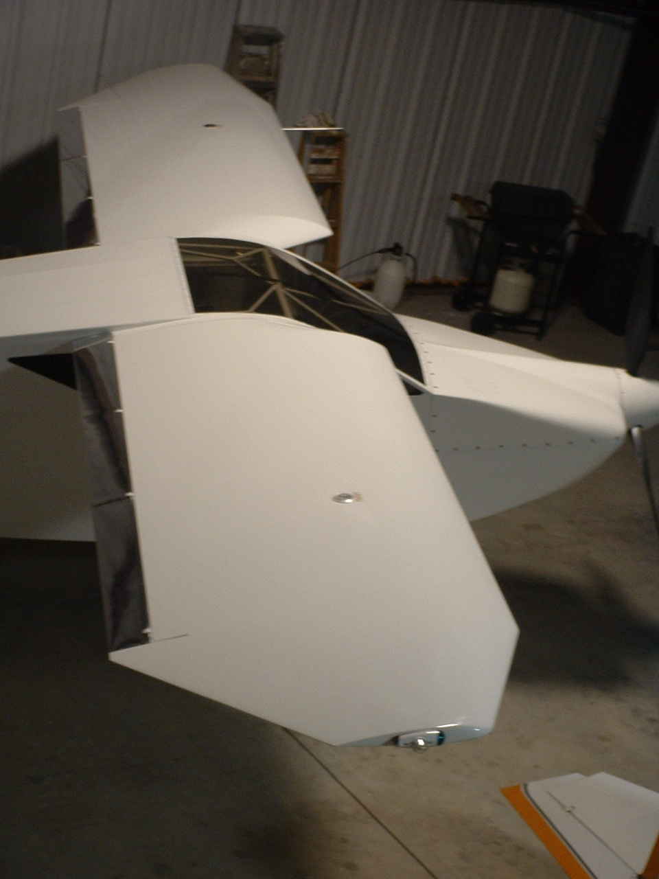

Phil, The Tailwind people are mainly using the Yahoo forum now instgead of Matronics, with over 630 members and growing nicely very active. Check it out: http://groups.yahoo.com/group/TailwindForum/
Jim Rusk is a carbon fiber pro, and he has 50 gals of fuel in his wing tanks. Wings are wood. He may give his view, if you ask for it, he is on the Yahoo forum. I think he questioned whether it was worth the extra work involved. Also fueling the plane is not so easy.
Attached is a picture of his wing and you can see the tank fuel caps. George
 Filesize:  963.55 KB
 Viewed:  1634 Time(s)
sbarrie8281(at)charter.ne

rx7tailwind <lbosch13(at)msn.com> wrote:
"rx7tailwind"
Hey guys, thanks for all the replies...I'm getting more excited about the
possibility of wing tanks. Looking at the wing design (see attachment) wing
ribs 4,5 and 6 could be replaced in between the spars by a tank made of
fiberglass with wood stringers on top and bottom so that the plywood skin
can then glue onto the stringers. wood in front and back of the tank
structure could help attach to the top of the spars...but before I do
anything, I'll look at what others have done. No need to reinvent wheels
here...any ideas?
http://forums.matronics.com/viewtopic.php?p=104257#104257
http://forums.matronics.com//files/wing_drawing0001_443.jpg

PostPosted: Mon Apr 02, 2007 11:11 am    Post subject: Wet W10 wings anyone? Reply with quote
Problem is that when you look at the area available between the ribs, you have less than 6 gallons available. I decided it was not worth it and will use a fuselage tank behind the seats.
Callbie's metal wing would be the way to go for tank capacity.
