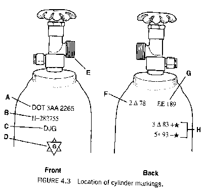

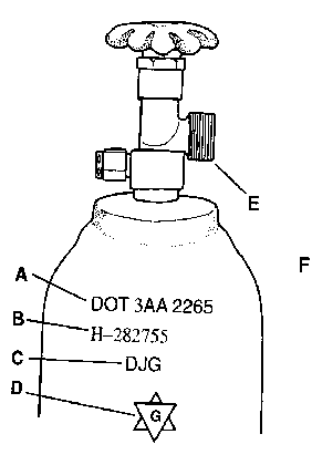

Cylinders Con’t
Special markings on "shoulders" to designate:
[b]DOT specified materials
Example: 3AA: seamless, high strength, heat treated alloy
Service Pressure: 2015 psi
Serial # for that cylinder
Manufacturer’s mark
Owner’s Mark
Reverse side:
Hydrostatic testing date
Inspectors mark
Retest date(s) : star indicates 10 yr cycle

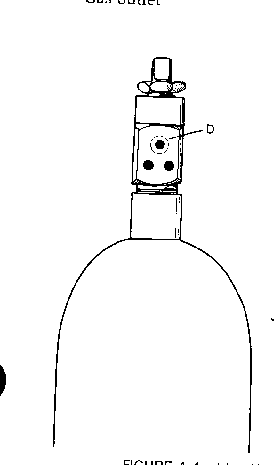

Pin Index Safety System
  • Specific placement of TWO holes drilled into valve stem.
  • Placement defines which gas in cylinder
  • Paired #s for each
Example:
2-5 Oxygen, 1-5 Air, 3-5 N2O

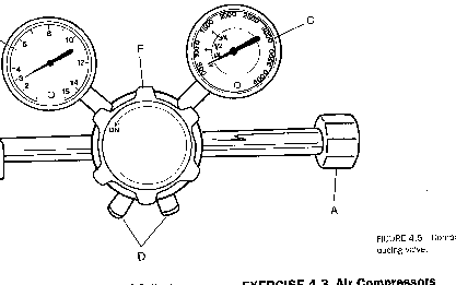

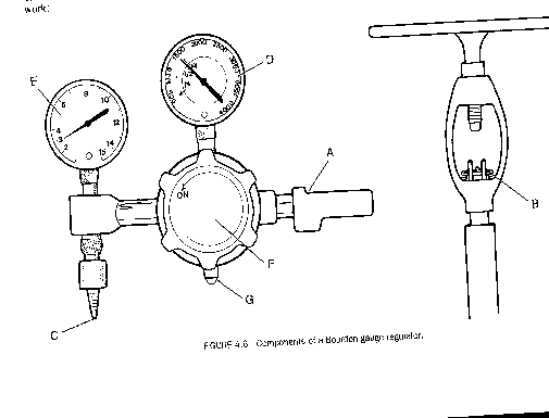

REGULATORS
Two sections:
1) Reducing valve: allows 2200 psi to be reduced to a safe pressure of 50 psi
2) A flow device
E or smaller, YOKE style
Larger than E, threaded regulators
Read pressure within tank off regulator pressure gauge
Pressure Gauge Readings
Open the valve of the tank and read the pressure on the gauge
Full should be 2200
Use conversion factor to find out how many liters of gas available
