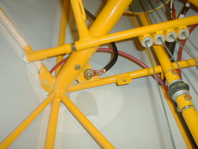

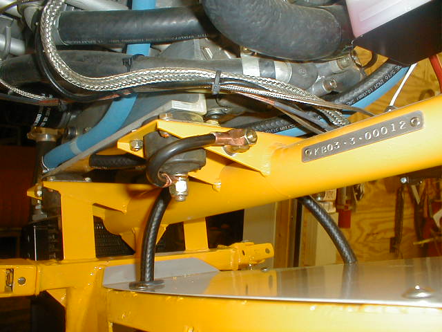

Hey guys,
I came up with this idea for a good ground attach point for the ground cable to airframe point. Its a GM side post extention that is made for external amps in cars and I think it will work better than just bolting the cable end to the airframe. It is made out of brass and with dieletric compound should make a nice solid connection. If any want the part number let me know. They are available at any NAPA store. Also there is a "thinner" 3/8" nut for the back side of it that can be found on a GM starter. It leaves the "2 threads" extruded that the DAR's like. Someone may can come up with an AN nut. I just robbed a starter and used the star shaped locking washer. Wink

That is very clean looking, and should be a solid ground.
Joe
