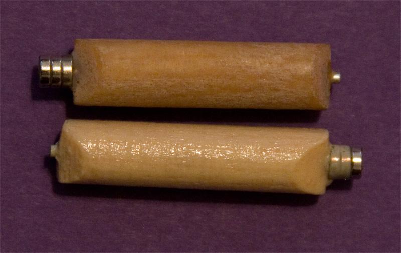

Regarding the Kreem. I checked again this morning for the purpose of this
note, the floats I have been soaking in denatured alcholol and mogas. As
reported previously, the vinyl ester resin float has the typical (typical as
far as this test is concerned) dull mat surface going to a frosted white
appearance in some areas. The Kreem coated float also has it's typical
appearance - a shiny surface not different in any way from the day it was
inserted into the alcohol bath.
I have read that when resins cure, they cure in chains of molecules forming
a matt like matrix with areas of lesser cured resin interspersed - much like
glass mat with resin. It is my thought that the alcohol attacks the
interspersed resin which gives the dull non reflective surface and also
explains the multitude of tiny bubbles given off when the float is once
again returned to it's bath and taken up to the test altitude of 14,000 ft
in the bell jar.
It is interesting to note that the liquids in the tubes have darkened in
color as illustrated in the photo. From left Vinyl Ester (VE) in California
auto fuel (6% EOH), VE in 97% EOH, Kreem in 97% EOH, VE in 97% EOH (This
needs explanation, The 2OZ refers to the mixing container I used. In this
case it was one of the small 2 oz. condiment containers commonly used in
restaurants (?) for on the side salad dressings, tarter sauce, etc. I
wondered if the brief contact with the plastic cup would contaminate the
resin - conclusion, yes. The resin for all the other floats was mixed in a
glass container). The far right tube contains auto gas with the JC Whitney
tank sealer, which behaves identically with the Kreem, but as you can see it
is snow white and did not change the color of the fluid bath.
The other photo is of the floats in the 97% EOH. Notice the sheen on the
Kreem and the frosty patches on the VE resin. A fingernail on the VE resin
indicates some softening. These have been soaking in denatured alcohol for
six months and 4 days.
A note on VE resins. There are numerous formulations for various
applications. It is difficult to impossible to find in small quantaties as
we would need for tanks. The material I used is from ACS and comes in an
essentially non labeled can. From their catalog it is listed as a 3M
product and that is as far as it goes.
Lowell

Great report Lowell. Thanks. Am I correct that your personal opinion is
that properly applied Kreem is an effective deterrent against damage from
Ethanol?
Deke
| - The Matronics Kitfox-List Email Forum - | | Use the List Feature Navigator to browse the many List utilities available such as the Email Subscriptions page, Archive Search & Download, 7-Day Browse, Chat, FAQ, Photoshare, and much more:
Back to top |
dosmythe(at)cox.net Guest
Posted: Wed Apr 04, 2007 1:13 pm Post subject: Glassfiber tanks and ethanol (Kreem) |
lowell,
As usual, you get down to some serious testing even to the point of
making those professional little labels. I will sometimes back down and can
even change my mind when solid facts are presented. As Deke implied, are
you getting prepared to say (from your test) that Kreem might be an
acceptable product to protect the fiberglass tank from ethanol. I still
have to ask, what if a small section of the tank gets untreated or a crack
develops later down stream?

This is a tough question to answer actually. At one time, and Deke is privy
to this, I used the Kreem over an epoxy base on the floats. I guess the
idea was to create a firm base for the Kreem like in our tanks. We had one
instance where the epoxy bubbled under the Kreem causing a mechanical
interference with the float's movement. I had had the low fuel system in my
Model IV for about four years and this was a real heads-up. Since then I
have been looking at a single coating system for the floats. What I want is
the failure mode to be false positives as might happen if the float lost
buoyancy rather than simple non operation like the Ray Volk report when he
told me that the optical cone in his optical low fuel indicatior system
simply melted in the fuel and dropped, as he said, to form a Hershey's Kiss
like mound on the bottom of his header tank.
My feelings are that Kreem is pretty much impervious to auto gas and
alcohol - at least for the 6 months duration of my test and expect the Kreem
to go on for a long time in the future. I am curious how long the Vinyl
Ester will keep the floats floating. My advantage with the floats is that
they are of balsa wood and the Kreem will soak into the outer fibers and
there is no way the Kreem will come off. There is one difficulty that has
arisen when the end grain of the balsa has large pores. The Kreem will not
bridge these even with the three brush coats I give them. I will then mix a
bit of micro balloons with some Kreem and apply it to the pores with a very
small spatula. I give the floats the three coats with a full drying period
in between. I guess the past experience would suggest that the weak spot in
the system is the preparation of the glass surface for Kreem adhesion
coupled with Kreems inability to bridge large voids (Maybe #60 drill size).
That said, I suspect voids in the lay-ups that large to be quite rare to
non existant.
I like Kreem's resistnce to alcohol and Mogas and have had it in my tanks
for nine years - I did re-slosh one tank about three years ago, though.
When building, I had one tank not fit the wing spars - not jigged properly
when closed at the tank shop and as a result I have tanks from two separate
batches. The (good) left tank was the replacement tank, ca. July 1993,
whereas the resloshed tank was in the kit, ca. March 1993.
