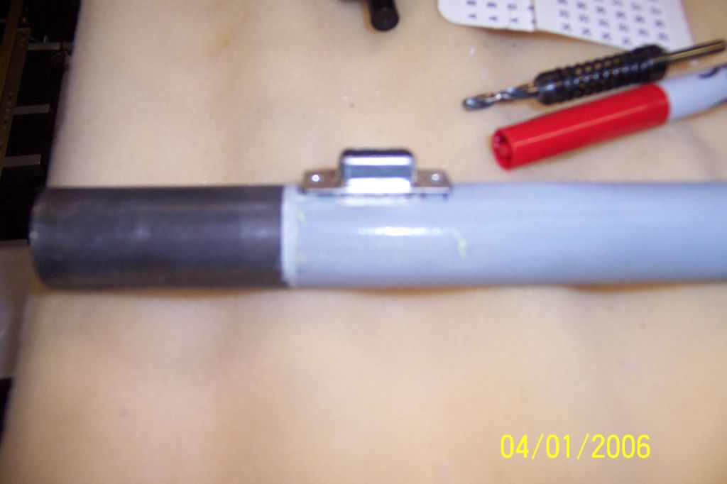

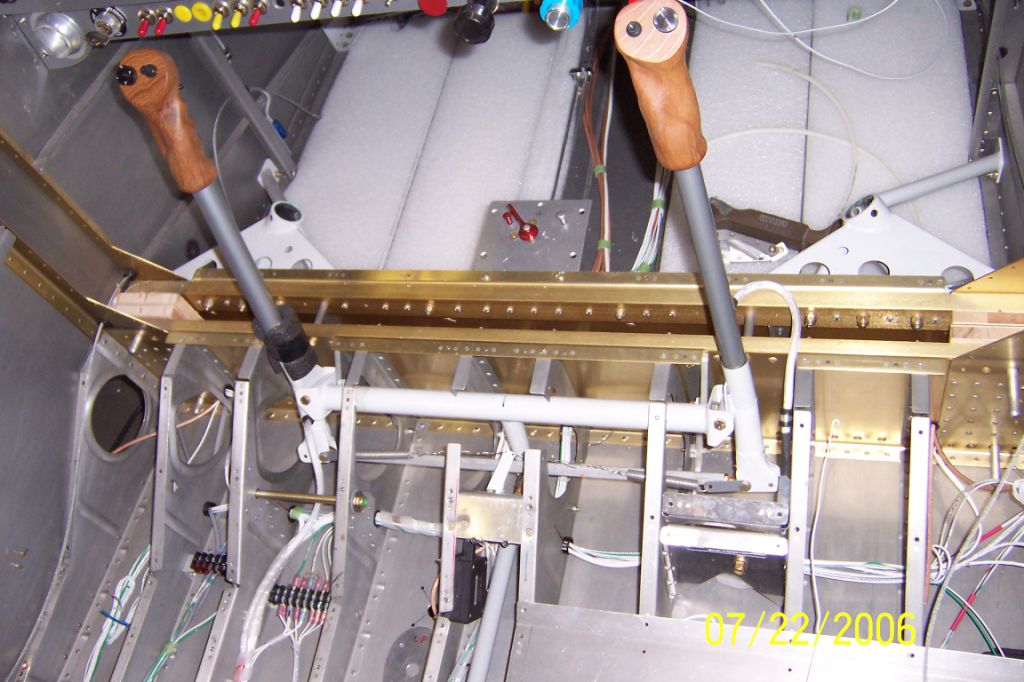

Here is my variation on that theme. This is just another way to handle the
Pax wiring. Used a DB9 connector inset into the pax control stick just
above the area that goes into the column. Sorry for the bad pix. Plugs or
unplugs easily to remove stick. Adel clamp makes sure there is no
interference. Loop goes in the open area of the seat. Will probably use a
little custom clip on the DB9 to make sure it stays in place when you want
it to.
Bill S

lifeofreiley2003(at)yahoo Guest
Posted: Wed Apr 18, 2007 8:24 pm Post subject: PAX Stick |
Bill,
I must say... that is a brilliant idea. The pic came
out well enough to make the point.
Thanks for the reply.
Darrell
