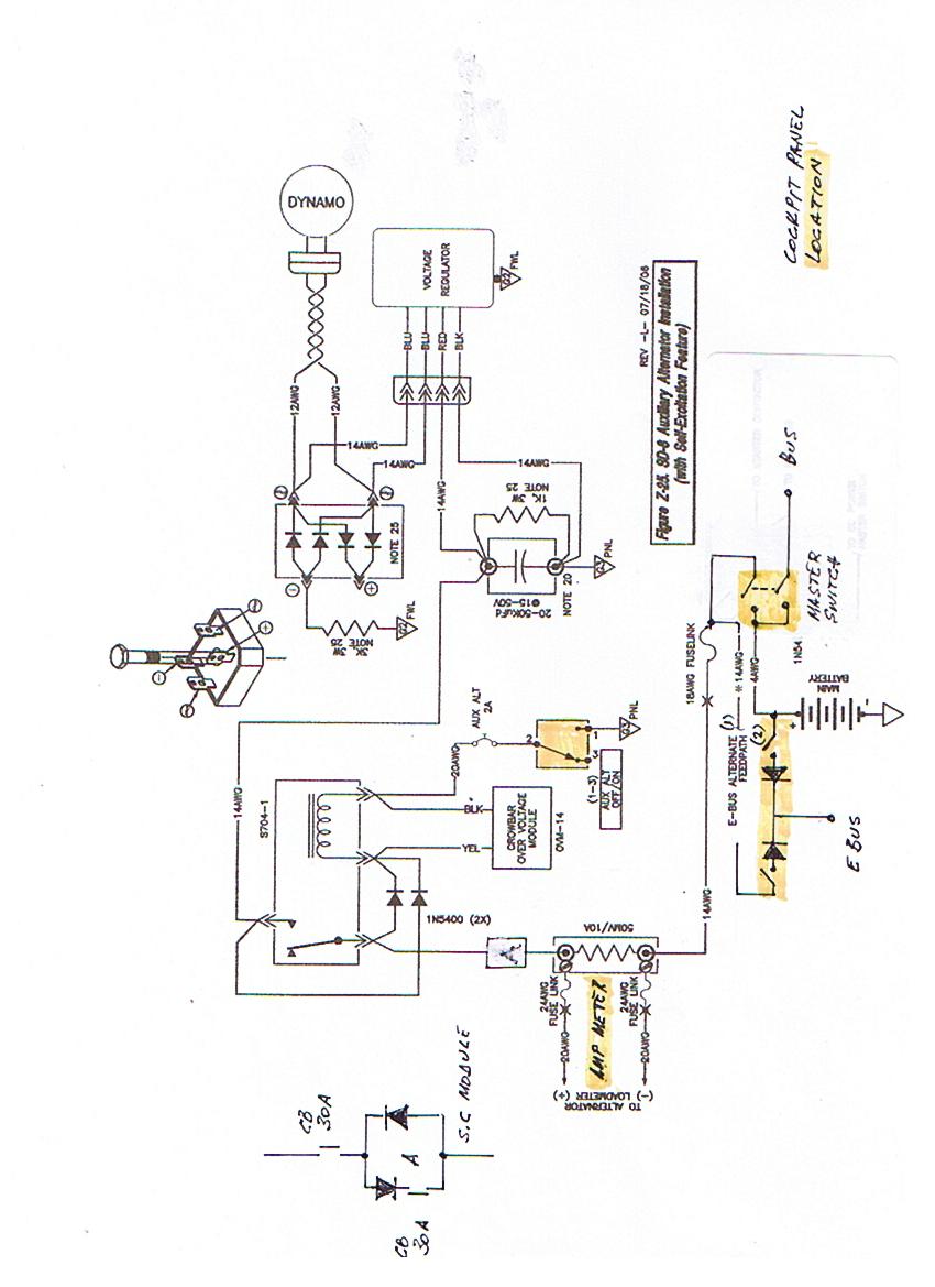

Hi again, more questions,
As a newbie I get to make my share of mistakes. I have taken the liberty to modify Z-25 to show an over current module and a dual power outlet for the essential bus and I would welcome some guidance along the following lines:
<![if !supportLists]>1. <![endif]>The OCM item A I inherited from another project, a Norton rotary engine install with 3 phase solid state regulator rectifier. It is supposed to protect against over current from a short in the alternator or on the battery side. Question : Should I keep it ? Is it in the right place ?
<![if !supportLists]>2. <![endif]> Is the dual alternate feed path for the dual supply to eBus OK ? It should supply from the self excited PM alternator/regulator, or from the battery, or both (normally both) Should those two switches be protected ? How ?
<![if !supportLists]>3. <![endif]>Should I consider a switching sequence for start up and shut down ? Details?
If you read this far you will know that I have just enough knowhow to get into trouble and I would appreciate any comments. If the html diagram does not post below I will set it up in the pictures section.

Peter,
| Quote: | 1. The OCM item A I inherited from another project,
Your diagram already shows a fuselink. With your setup I would install
it direct at the battery positive post. I always choose the simplest,
lightest, least expensive device.
This module seems to include a 30 amp CB. This means running a fat wire
from the battery + to the intended location.
| Quote: | 2. Is the dual alternate feed path for the dual
That's a lot of switches to manage. What purpose did you say the dual
E-bus supply was for ?
| Quote: | Should those two switches be protected ? How ?
I would protect the E-bus alt feed with a fuselink or something direct
at the battery.
| Quote: | 3. Should I consider a switching sequence for start
Since those switches are "alternate feedpath", I would leave them always
open except in case of alternator loss (real or simulated). In that
case, I'm trying to figure out why you would need the "direct from
alternator" path ?
Especially if you decide not to (or forget to) close the alternator switch.
Please note that the OV module will only work when the alternator switch
is closed. In a worst case situation, you may well fry your avionics
while attempting to sort out an OV event and closing the wrong switch.
Better leave this "alternate alternate" out.
The Jabiru is a simple engine. If it were up to me, I'd control the
alternator through the master switch, a' la figure Z16.
Best regards,
Gilles
http://contrails.free.fr

Thanks Gilles,
The principle is to make use of the self excitation feature to make a dual
power supply that would work either from the battery or from the alternator
or both. I am planning to fit EFI to the Jabiru 3300.
Re 1. Suppose I would quit the fuse link in favour of the OCM which
automatically resets. ? It could be relocated closer to the battery.
2. The dual ebus is for the EFI covering an ECU and a fuel pump. It
could also supply a single electronic ignition module and I would plan for
say 8A I was planning to leave those switches normally closed and opened
only if for some reason I wanted to isolate from either the battery or the
alternator. Ie that is not an alternative path it is for the sole supply for
the EFI.
3. I overlooked the need for the alt relay to be closed. I would want to
connect that line to the alternator side of the alt relay and protect it?
What do you think?
Thanks for the help.

Hi Peter,
| Quote: | Re 1. Suppose I would quit the fuse link in favour of the OCM which
I would be wary of any system automatically resetting without me being
in the loop.
| Quote: | 2. The dual ebus is for the EFI covering an ECU and a fuel pump. It
the EFI.
I understand your engine setup is to be electrically dependent.
I had the same problem and solved it with figure Z16 and an auxiliary
battery to feed the fuel pump as a last resort. The aux battery only
connects when the bus voltage is above 13 volts, and automatically
disconnects when bus voltage falls below 13V (dead alternator/regulator,
flat main battery, etc.).
According to the Jabiru engine groups, the Jabiru voltage regulator has
a less-than-stellar service reliability. The safest current source in
your airplane is a well charged battery.
| Quote: | 3. I overlooked the need for the alt relay to be closed. I would want to
Not sure to clearly see what circumstances would lead to the necessity
to use the alternator and not the battery ?
Rememeber that the more switches you have to manage, the more likely
pilot errors.
Best regards,
Gilles

I have just realized that the alternator disconnect relay in Z25 is wired to
trip by the OVM and isolate the alternator if there is a spike but I am
thinking that I would not want to disconnect for the sake of a transient
which could be taken by the OVM safely to earth .
But does the OVM have sufficient current capacity to carry for a failed
regulator? Can we assume that the PM alternator will be saturated at about
20A ?
( I will run out of questions soon I promise)
Peter

Peter
Yes we like to use diodes or something to recycle the inductive energy
when things like contactor coils are de-energised. However for practical
purposes, spikes or "transients" capable of doing damage don't really
exist in our systems.
An OVM tripping event is not instantaneous. If the overvoltage lasts
long enough to trip the OVM, then it is about long enough to fry most
devices (such as transorbs) designed to limit/absorb excess
voltage/energy. Further, if the overvoltage is that long, it is most
certainly coming from an out of control alternator and you want that
disconnected before it can damage other electronics such as your EFI.
Yes the OVM can limit the voltage for the few tens of milliseconds that
it will take for the relay to open.
For a more direct answer to your question:
A 20 amp PM alternator won't put out much more than 20 amps under any
circumstances but little solid state protective devices can only absorb
that kind of power for a few millecseconds, thus the need to disconnect.
I have never had a false OVM trip with either of my OVM's that are of
the current design. I have had real trips when my PM regulator failed.
Nothing else was damaged. If it trips you can always turn it back on and
watch it trip again if the voltage still rises too high.
You definately want notification of low voltage to warn you of a trip or
alternator failure. My Grand Rapids EIS with the Big Red flashing Light
is effective for that.
Ken

Thanks Ken that clears it for me and now I know with certainty to use the
alternator contactor relay/OVM .
I understand that the OVM will trip before damage to the remainder of the
circuit.
Peter
