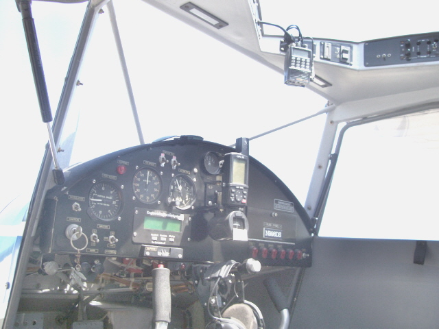

dosmythe(at)cox.net
PostPosted: Tue May 22, 2007 3:12 pm    Post subject: Straight Breakers vs. Breaker Switch? Reply with quote
I agree that being able to get to the fuse box "might" be helpful in flight.
See the attached pic of my panel. On the far right you see a rectangular
area in the face of the instrument panel. There is a small knob at the top
that opens the door. Behind the door are the automotive blade fuse holders.
There are also extra fuses in that area. You can open this door in flight
and get access to the fuses. There is also an emergency bypass switch
behind the door that will bypass the master solenoid if that solenoid should
fail in flight. You can regain connection from the battery to the main buss
if the solenoid fail.
Don Smythe

I can heartily agree with Bob Nuckols reasons for liking fuses over breakers...but removing blade fuses and even locating blown circuits while trying to fly a plane can be interesting. Breakers give the control/visual cues I prefer.
As for your comments on wire size, burning, Etc. Right on! The wire sizes should be chosen for de-rated current draw. This means that there should be no splices into wires to power any one of numerous frivolous devices. If you really need it add an extra protected circuit. Make sure that all your wiring is protected... most certified aircraft will actually have one side of the buss attached directly to it's buss so the whole circuit is protected.
Having worked with both coloured wires and certified white wiring I now feel much more comfortable with the white wiring. The wires themselves are manufactured to more exacting tolerances. The insulations are less likely to burn and are much more rugged. There are many shielded cables available in different sizes. Finally the wire charts in AC 43 will work with certified wire... I don't think I can say the same thing about automotive style wire in its myriad of Sesame Street colour.
[img]cid:855291502(at)25052007-0421[/img]

PostPosted: Thu May 24, 2007 8:52 pm    Post subject: Straight Breakers vs. Breaker Switch? Reply with quote
You don't need to restrict yourself to the color white if you want to use the higher quality Tefzel wire. It is available in just about any color including multi color. As to fuses vs breakers, I have wired quite a few airplanes and have done it both ways depending on what the owner wanted. The auto type blade fuse blocks work very well and result in a clean, light, and simple system. Never mine being able to reach them during flight. If you have designed your electrical system correctly there should never be a need to replace them while flying. For both of my own projects I chose to use a combo of switched and pull type breakers cause that's what I wanted. The important things to keep in mind are to use quality components, think through the most likely failure modes, and don't forget you will need to service something years from now. The first and last items are what frustrate folks most often. Usually in the form of a poor quality component at the end of a wire that's too short and unreachable.
