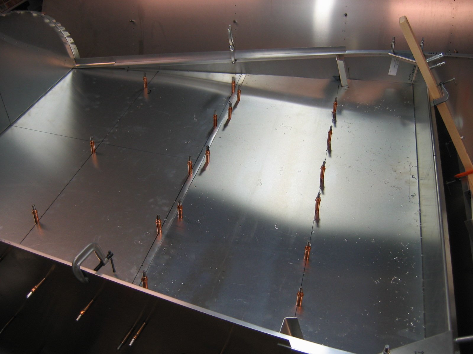

DaveG601XL
Joined: 27 Oct 2006 Posts: 351 Location: Cincinnati, Oh
Posted: Tue May 22, 2007 7:45 am Post subject: Re: Baggage floor |
I did what Jay did and split the floor down the middle. If my attached picture worked, you can see the double row of cleco's where I substituted a u-channel for the L-angle. The aft floor will have the side L-angles riveted to it before placing the floor in the fuselage due to the longeron proximity. The forward baggage floor will be left un-riveted until close to the end.
