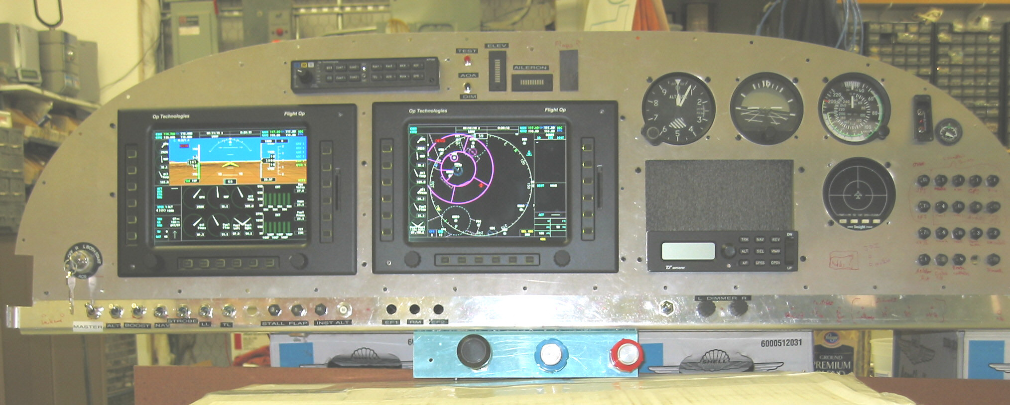

PostPosted: Sat May 26, 2007 5:49 am    Post subject: The Perfect Panel - The Perfect airplane Reply with quote
Her is my Idea of a panel. You'll see Srikefinder for legal weather but there will be a garmin 496 also on board until ADSB or some other form comes in.
Fully intergrated 8.4 and an extra 1201 wass approved GPS.
We're fitting it in now.
Patrick Thyssen 257

PostPosted: Sat May 26, 2007 1:08 pm    Post subject: The Perfect Panel - The Perfect airplane Reply with quote
Patrick,
What is "legal weather?"
William
http://wcurtis.nerv10.com/
jump2(at)sbcglobal.net
PostPosted: Sat May 26, 2007 2:50 pm    Post subject: The Perfect Panel - The Perfect airplane Reply with quote
I will correct myself as per 135 or 121 far, you have to have in the case of known or forecast thunderstorn weather you have to have on board a airborn radar or a lighting detector (wx500,strikefinder etc.). That means real time not 15 minutes old weather. And no this is not 135 but I have enough experience to know not to just rely on ground base systems if I want to go.
patrick thyssen
William Curtis <wcurtis(at)nerv10.com> wrote:
[quote]--> RV10-List message posted by: "William Curtis"
Patrick,
William
PostPosted: Sat May 26, 2007 5:50 pm    Post subject: The Perfect Panel - The Perfect airplane Reply with quote
Patrick,
Thanks for the clarification. That's a nice looking panel you have there. I've been meaning to reply to the other thread where folks are confusing XM weather as airborne radar. They should understand the lag time (2 to 15 minutes) involved with XM weather so as NOT to use it to try to closely navigate around weather cells.
William
