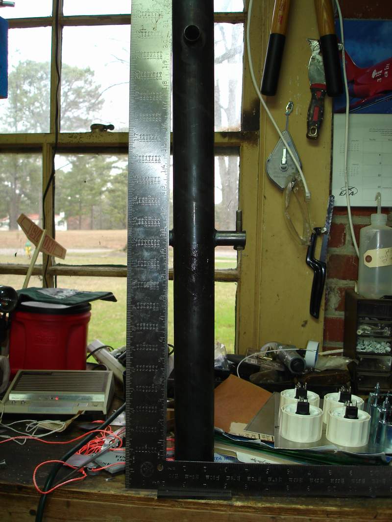

I drilled the strut bottom plate on my 701 Nose Gear. I clamped the Fork and Fork Doubler to the plate and sat the parts down to get my drill ready to drill through the pilot holes. I noticed that the strut seemed to be listing to one side (I was not in the Navy, but like that word "listing").
I got my square out and placed it flat against the bottom plate. When I pulled it up to the strut, there appears to be at 10-12 mm difference between the bottom and the top. In other words, it looks like the strut is not welded flat against the bottom plate.
Has anyone else had this to happen? Is it out of tolerance? It seems to me that if it is left in this condition, then tire will set at an angle.
I sent the picture to Nick at ZAC, but havent heard back yet.
Thanks for any/all replies. I'm attaching a picture.

Tommy,
You're right, you need to fix it or it will "list" a bit and never look
right as well. You might even have a one-sided torque on touchdown.
It would appear that you need to saw off the plate, place the top end in
a lathe and the other near-end in a steady rest and re cut the end face
of the tube to square it. I can't imagine any other way to square one
end as perfectly. Presume the tube was cut on a saw or the jig was
not square when tacked. Lots of ways to not get this right. Not too
hard to fix after cutting it apart and then squaring it off with
a square placed against the side and across the end to check progress
correcting it. Care in welding a new plate square is even more
important.in all three axis. If they are willing to replace it for
you with a "good one" that might be your easiest course of action.
But don't accept the idea of shimming it to square.

I never checked mine but that sure doesn't look right.

I just went downstairs and checked my gear. Mine is square.
I'm sure ZAC will replace it.

Neither me, in this flying time (35 hrs) never noted anything, just for curiosity I will check it saturday... Probably not, flys great and no time to make "repairs" now Smile
Now that you mention it, I also kind of noted the engine mount not straight, came twisted to one side, but flys great so I left it as is Smile Smile Wink

I wouldn't accept it, nor would I agree to fix it myself. ZAC should replace it or fix it for you.

I am sure there will be no problem at all for ZAC to replace (or repair) that nose gear.
They do sometimes (just for service), send parts WE as builders damage and they send it even in some cases free of charge!
Just ask them for instrucctions and you will recieve the part very soon.
Given their shop size. They give Better service than we can spect, same from Chez...
Yes, First hand experience.
