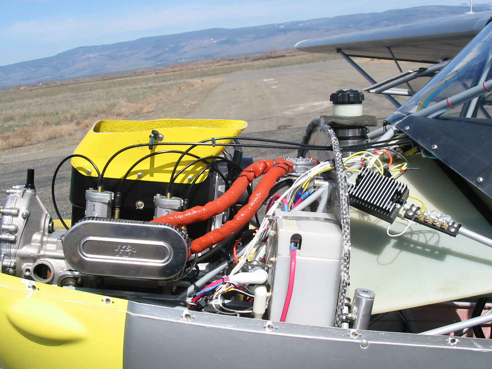

Thanks guys! It sure does appear something is amiss if other 503s don't weep fuel out the fuel pump weep hole. Here is some more information and a couple of photos of how the fuel pump is installed.
The pulse port is just under the bottom and in front of the front carb. The pump is on the fire wall 9 inches higher than the pulse port in level flight. The pulse line is 1/4 inch rubber automotive fuel injection line. The front half of the line is mounted level under the carbs then the rear half travels up slope at about 45 degrees to the fuel pump. This is how the kitfox manual shows to do the installation.
The pulse line is 20 inches long. Rotax recomends a shorter line. I can't tell if the line is full of fuel because it is not clear. Today after one hour of flight at 6000 RPM the catch tube had almost exactly one ounce of fuel in it. The fuel in the catch tube is dirty black so I am pretty sure it came from the crank case.
Any more ideas why this is happening or how I can/should change the installation?

PostPosted: Tue Jun 12, 2007 5:18 pm    Post subject: 503 fuel pump weep hole makes a mess Reply with quote
installation?
Tom Jones
Classic IV, Phase one
Is it supposed to be horizontal like that? -- maybe it doesn't matter.
Malcolmbru(at)aol.com

PostPosted: Tue Jun 12, 2007 8:20 pm    Post subject: Re: 503 fuel pump weep hole makes a mess Reply with quote
It is better to have the pulse line leaving the engine going up to the pump so if any fuel does get in the line it would drain back to the engine. If you can't move the pump higher then loop the line so it is going up for a few inches first then loop back down to the pump.
The pump is 9 inches above the pulse port but the line is level from the port for about 10 inches then a 45 degree slope up to the pump. Fuel may be pooling in the line and working its way up that gradual slope to the pump. I have some clear pulse line on hand. I could put that on with an immediate straingt up 7 inch rise from the port then level to the pump. That would be about 22 inches total pulse line length though. I will see if there is a place closer to the port to mount the pump.
if the pump is leaking it will come out the hole
This engine pump combination has done this from the beginning right out of the box. I put a new pump on and it does the same thing.
if the crank case is filling up it will come out the hole
The engine runs perfictly. Temps in the green and plugs brown. Turns 6200 on full power climb 800 ft. per minute at 60 MPH.

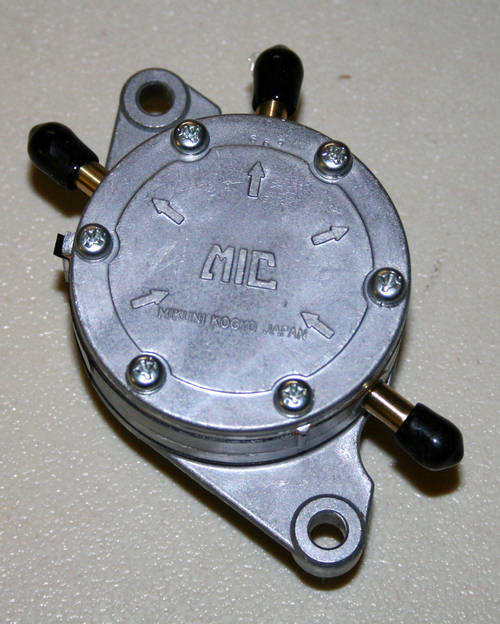

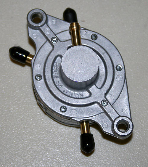

Speaking of weep holes on 503 Mikuni pump, can anyone tell me where in the following photos the weep hole is located? Also, is the pump supposed to mounted so that the pulse line inlet side of the pump is up or down or does it matter? I'm trying to help a guy inspect a Challenger with 503.

PostPosted: Wed Jun 13, 2007 5:46 am    Post subject: 503 fuel pump weep hole makes a mess Reply with quote
Tom,
Not all pumps have the weep hole.
Mount the pump so that the pulse line side is down so any liquid will
drain out away from the pump diaphragm.
The diaphragm must always remain free to move with the pulse
frequency to pump properly.
Only a pump with a slowly leaking diaphragm will benefit from a weep
hole if mounted properly.

Thanks guys. Much appreciated. Looks like the Challenger has its fuel pump installed upside down, as I suspected.

PostPosted: Wed Jun 13, 2007 6:44 pm    Post subject: 503 fuel pump weep hole makes a mess Reply with quote
I have all three types of the Mikuni dual pumps that are currently on the market. The two most often found at ultralight suppliers are those pictured in the CPS article previously posted to this conversation. The third I found at a go kart shop.
The oldest of my three is the one with one straight and two bent hose barbs. On this pump, the pulse port is a square brass fitting with a hose barb at 90 degrees pressed into a boss, about an 1/8th inch tall, on the back of the mounting plate. The weep hole in this style pump appears to be factory drilled.
The one I bought from CPS last year is the one with all straight hose barbs. On this style, the pulse port boss is about 3/4" tall and the hose barb is pressed into the side of it. In the CPS article, Mike said they drill the weep hole on these and that appears to be correct.
The third style is one I first saw on eBay this winter. I went searching online and found it at Go Kart Supply. This style has the pulse port boss cast into the front cover and the bent hose barbs are turned outward 90 degrees to the mounting surface of the pump. The weep hole is drilled in a small divot in the center of the pulse pump boss and appears to be done by the factory.
My criteria for factory versus distributor drilling of the weep hole is simply whether it is centered where it's drilled. The one from CPS is drilled willy nilly, the other two have the hole centered in the fitting or the boss respectively.

Okay to clarify some more. The engine now has 14 flight hours on it. It was broken in according to the rotax manual. Total engine run time including break in, prop adjustment, taxi testing etc. is about 20 hours. The fuel pump leaked from the beginning, that is why I put a new one on. The new pump leaks too. No cold seisures. Compression is good. I think the leaked fuel is black because it is the condensate rotax speaks of and thus requires the weep hole in aircraft fuel pumps. I think it is black because it is mostly oil. I think the fuel/oil is able to work its way up to the pump because of the weep hole.
I will replace the rubber pulse line with a plastic one to see if it helps.

What kind of tubing were you using, tubing made for vacuum
applications or black automotive type fuel line?
You should be using tubing for vacuum application, example what they
call pulse tubing sold by Lockwood and CPS, it has thicker walls so
as not to soften the vacuum impulses. The automotive type fuel line
is not good as it too can compress under the pulses and soften the
vacuum pulses. It also can react to the 2-stroke oil and fuel
causing its layers to separate. These then can compress and reduce
the strength of the vacuum pulses - no pulses equal no or reduced
fuel flow. A Pennzoil rep at a past safety seminar acknowledge the
2-stroke oil together with the fuel breaks down automotive type fuel
lines which is the reason you see a different type material used for
fuel lines on 2-stroke marine fuel tanks.
