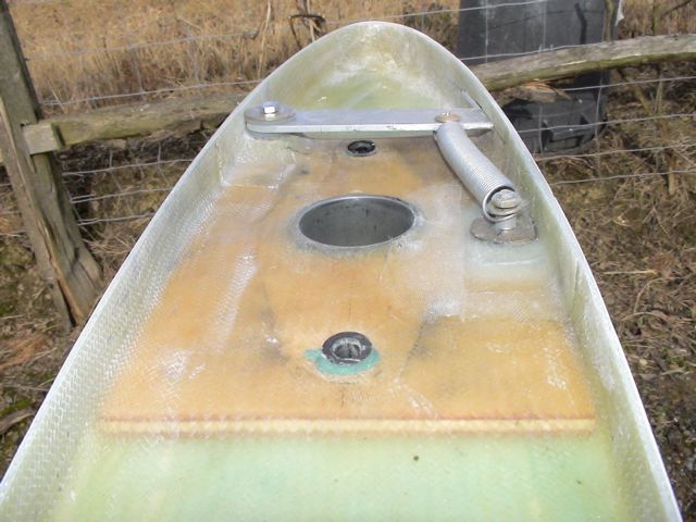

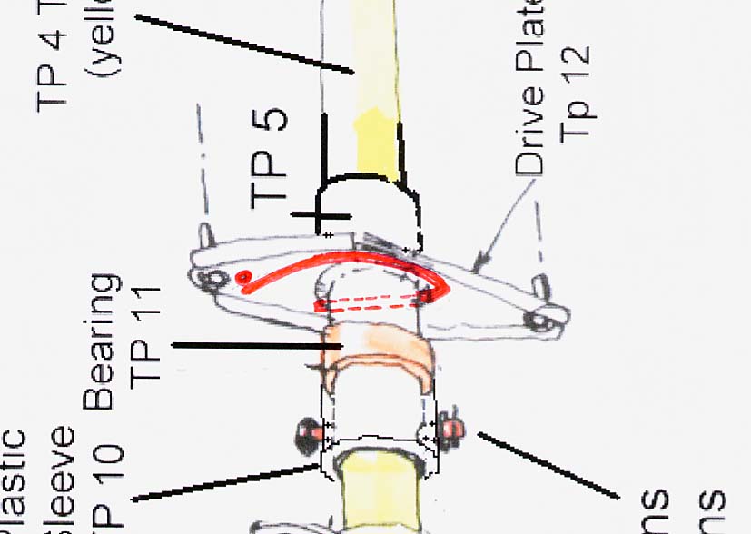

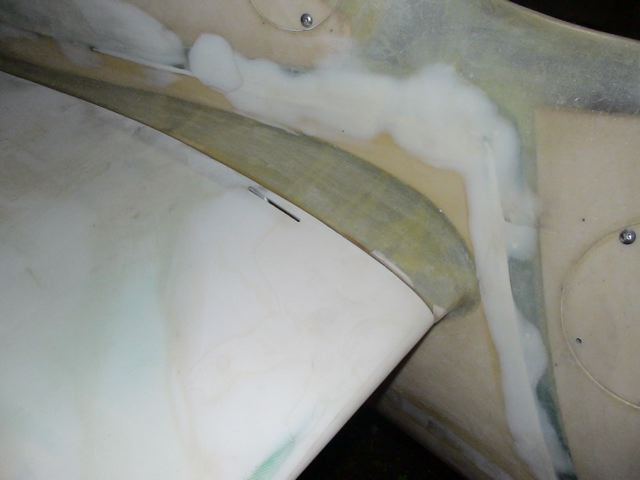

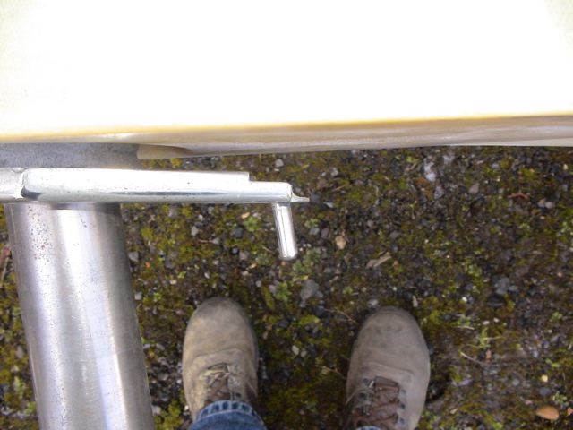

Dear Forum/PFA/Europa,
This mod has not been approved or tested and the photos are only of
a trial installation so please don't bother with too much negative
feedback - it wasn't even my idea originally!
It does fit the tailplanes securely with no load transferred to the
internal bushes.
I'm not proposing an alternative system, it's just an idea for
consideration by those who are reviewing the design of our
tailplane retention system.
Brgds,
Roger

Hi! Roger
I think the concept is an excellent one but.......(NOT BEING NEGATIVE)
a) I would prefer not to invade the existing drive plate and I don't
like sharp filed corners in "canware fabrications". I'd think that the
locator plate could be "fashioned" to engage behind the welded pin
without any filing of the drive plates.
b) I would prefer to have two such retainers on each tail plane fore and
aft of the drive plates. Both similarly "fashioned" as a) above.
c) I could imagine a temporary rigging prop tool to drop between the two
(as in (b) above) upstandings on the surface of the tail planes to
assist one man rigging to be removed prior to engaging the pip pins.
IMHO my clamps take care of the inboard problems, your concept as above
takes care of the outboard problems, this then only leaves the central
horn possibility!
But of course we mere mortals aren't yet privy to all that we are
looking to solve. To enable innovative ideas to be contributed it would
be more helpful for us to "see the horse before we start mending the
cart"!
Hopefully you have copied Ian Rickard in on this concept in time prior
to decisions being made about massive tailplane invasion.?
Bob Harrison G-PTAG
g-iani(at)ntlworld.com

Roger
Thanks this is GREAT. What we all want is this sort of thinking,
outside the box. Please do not apologise for any failings others might
spot. This may be the seed of the idea that saves us all a lot of
problems.

Perhaps it is stupid but I think about the following solution. Pre- load
the TP12 pin. Easy to do without taken the tail system in part. Drill a hole
just behind the TP 12 ( Perhaps only 4 mm ) Take a piece of spring metal.
Through the hole and than bench it around under load. I have no idea what
the pre-load have to be to avoid any movement on the pins. The spring can
be heavy due to the fact you can use a long piece and cut after assembly or
make a special tool.
My tail has already 6.5 mm play on the trailing edge and my plane did not
fly one meter. It has no play on the TP9. My holes are drilled at a special
workshop. It all look perfect but ....
Perhaps this is not a solution for the aviation...

PostPosted: Mon Jun 25, 2007 10:53 am    Post subject: Tailplane Retention Reply with quote
Nice idea, but fundamentally doesn't provide connection of the TP skin to
the outer pip pin hole (which I understand the PFA are looking for) in the
event that the outer bush becomes disbonded and grossly loose. .
