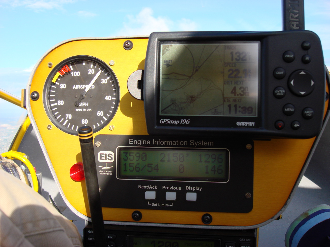

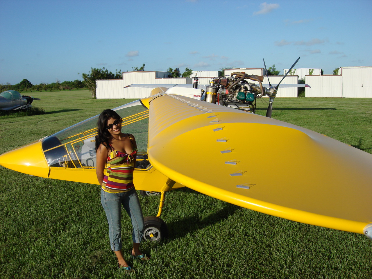

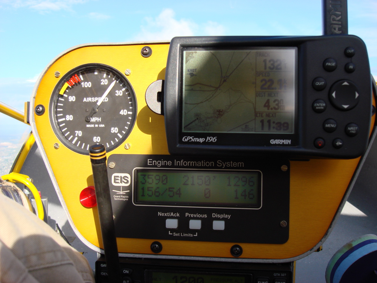

I put Vortex Generators on my Kolb MK III Xtra. I did not want to post just a first impression so I have flown with them for about a months so that I had a chance to really try them out in a lot of different conditions. The VG's have made a different airplane out of the MK III, not just in terms of reducing the stall speed, but in the feel of the plane at lower speeds. It used to feel like an approach speed of 60 MPH was needed to have a good margain of safety and control. Now, 40 on approach feels fine, although I use 50 minimum as a safety factor.
Stalls occour at 26 indicated, the plane is not really going this slow, as the GPS shows mid 30's stall with no flaps. I have the traditional seperate flaps and ailerons, and Stalling with flaps seems to be at the same speed as stalling without them, mid 30's. The stall is really a non event, the plane shakes 1/2 second before the nose falls a few degrees nose down, Its so mild that I have a hard time calling it a stall. Full aileron control is maintained throughout the stall, if a wing starts to drop anytime in the stall, a medium amout of aileron input immidately corrects it. I was teaching my wife stalls and of course her first reaction was to jerk the stick back as soon as the nose fell, she abruptly pulled the plane level at 33 indicated a couple times and never got a secondary stall.
Yesterday evening, I wanted to see if I could really fly an approach at a very low airspeed, so I went to 2000 feet, went to idle power slowed down to 35 MPH indicated, and put in a huge amount of aileron, banked 45 degrees and roughly jerked the plane around like an idiot, but was not able to get an accelerated stall or felt like I was about to lose it.
Landings were a real problem at first, I was in the habbit of landing with no flaps, and with the VG's the plane started to bounce badly on every landing no matter how smooth the touchdown. The airplane would touch down, but there was still enough lift being generated that it would fly again, even with a perfect three point landing... It was worse with a wheels landing. Landing with one notch of flaps totally cured this, im guessing that it pitches the nose down enough that it does not tend to pitch up on a wheels landing, and its going slow enough on a 3 point landing not to fly again. Now I land with flaps every time.
The down side is that it cost me some speed, im not sure exactly how much as a changed props at the same time I added the VG's, I lost 8 MPH in cruise with the prop change and VG installation. Im guessing at least 5 of that is VG related. I put the VG 's on with double sided automotive trim tape so that I could take them off if I ever wanted to. Overall im so happy with the way the MK-III flys and feels at slow speeds with VG's, I am more than happy to cruise a bit slower.
I used 140 VG's spaced at 2.5 inches apart from the center out to the wingtips. The VG's are in pairs and centered in the valleys of the ribs and face the airstream at a 15 degree angle, and placed at 10 % of the chord of the wing. Attached is a picture of the VG's on the wing, and my panel flying level with 3500 RPM just above stall.

Did anybody see any vortez generators??? Smile
[quote] --
mdnanwelch7(at)hotmail.co
PostPosted: Wed Jul 11, 2007 10:49 am    Post subject: Vortex Generators - Flight test report. Reply with quote
Very funny, George. Yeah, what airplane?? Also, notice how Mike
mentioned in his email how he had his lovely wife in the plane with him,
teaching her stalls, no less!!!! Gosh, should we be so lucky to have our
wives support us so!! I think it was a sly way for him to brag about having
a real sweetheart of a wife.
In case Mr. Mike reads this email, do you have any specs/details of the
VG's? Where did you get the design, and how far back from the leading edge
are they mounted?
Appreciate the
info, Mike in SW Utah

If you hold a magazine over the left half of the image, you'll see
the VG's!
