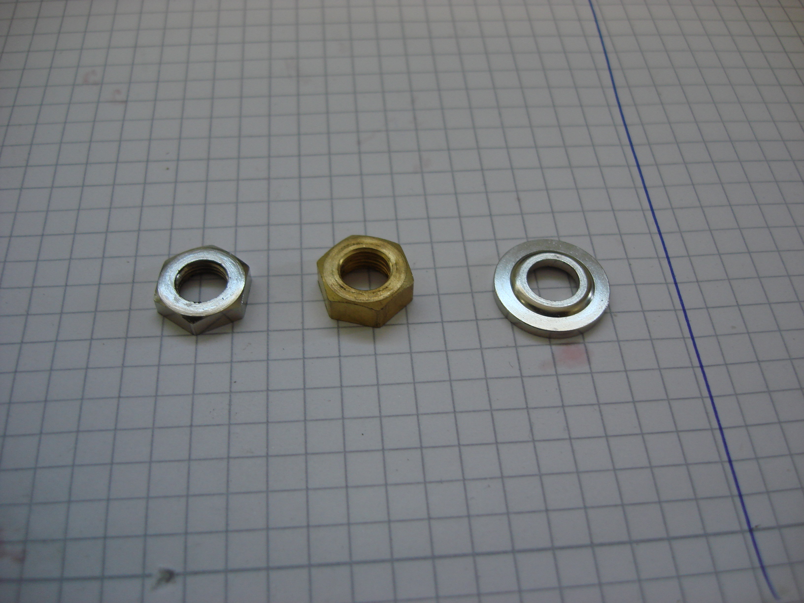

2.Question Front tire tube installation, did you remove all washers even the one which protects the tube see attached picture (washer on the right).

Posted: Thu Sep 20, 2007 5:51 am Post subject: Brake cylinder assembly question |
Michael,
Yes, it's the same, you need to remove a bleeder and move it to the other side to create a "right" caliper. The plans have instructions on doing this.
Yes, remove all the washers from the tube and beofre you install it for good, make a bend so the fill valve does not hit the fork unless you swapped out the wheel assembly and are not using the Van's supplied wheel.
