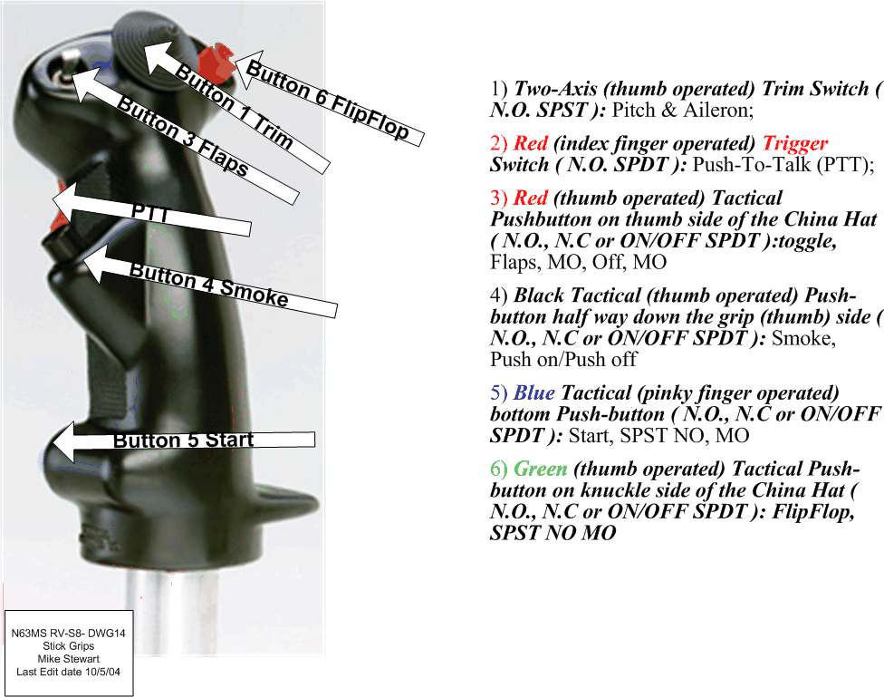

Anyone else pull their hair out trying to find anything on the infinity
web site?
I could use a wiring diagram for the infinity stick grips if anyone has
it...
Thanks!
-Bill

Don't know if the pdf attachments will go through. All of the information is on the website, though. Once you go through the diagrams it all begins to make sense. If you can't get these, mail me off line.
Love this grip!!

http://www.infinityaerospace.com/gripwire.pdf
It's not a diagram, but it does show all the possible switch configurations and wire colors. You can easily verify the wires to the correct switches with an ohmmeter. I printed it out and highlighted the switches and wire colors for easy ID.

They are made to order and should come with a diagram. Get out your ohm meter
and do a little testing and it will all make sense. Some of the switches are momentary, some are normally open some are flap switches some are....well you get the idea. If you contact
them you may find he has a record of it and can send/fax you a copy.

The basic grip went from $150 to $175 recently. The seller had not raised his pricing in 10 years.
One has to consider adding additional cable and any other custom item but of the 4 units I have ordered they all came in at just over the base price.
Rather than using his online or fax order system I always call. It simplifies all the research required to order exactly what you need (spacers etc…)
I am very happy with my Infinity grips.

I highly recommend ordering a lot of extra cable length- I ordered direct from ACS and the cable length was pretty skimpy. Probably better to get direct from Infinity. Also be very cognizant of which pushbuttons are included, such as momentary or on-off-on...
