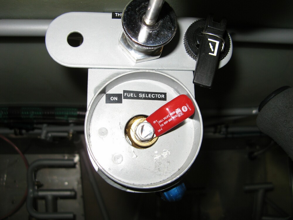

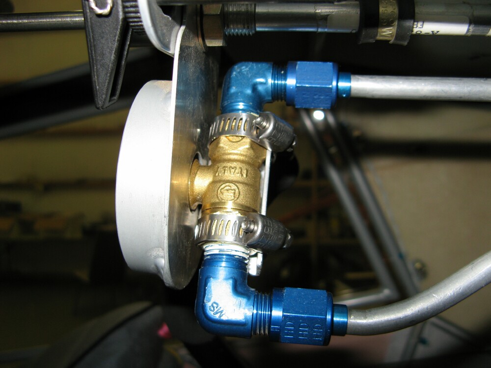

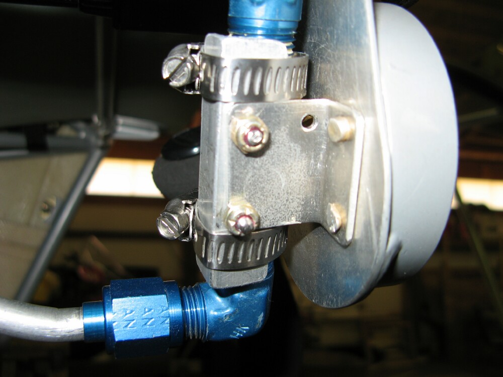

Three pictures worth 3000 words. The aluminum angle is 1/2 x 1/2 x 1//16 and is the same length as the hardware store ball valve. It is attached to the original skystar valve angle mount with two #4 screws and lock nuts. The selector handle is shortened to fit in the protector bracket.
