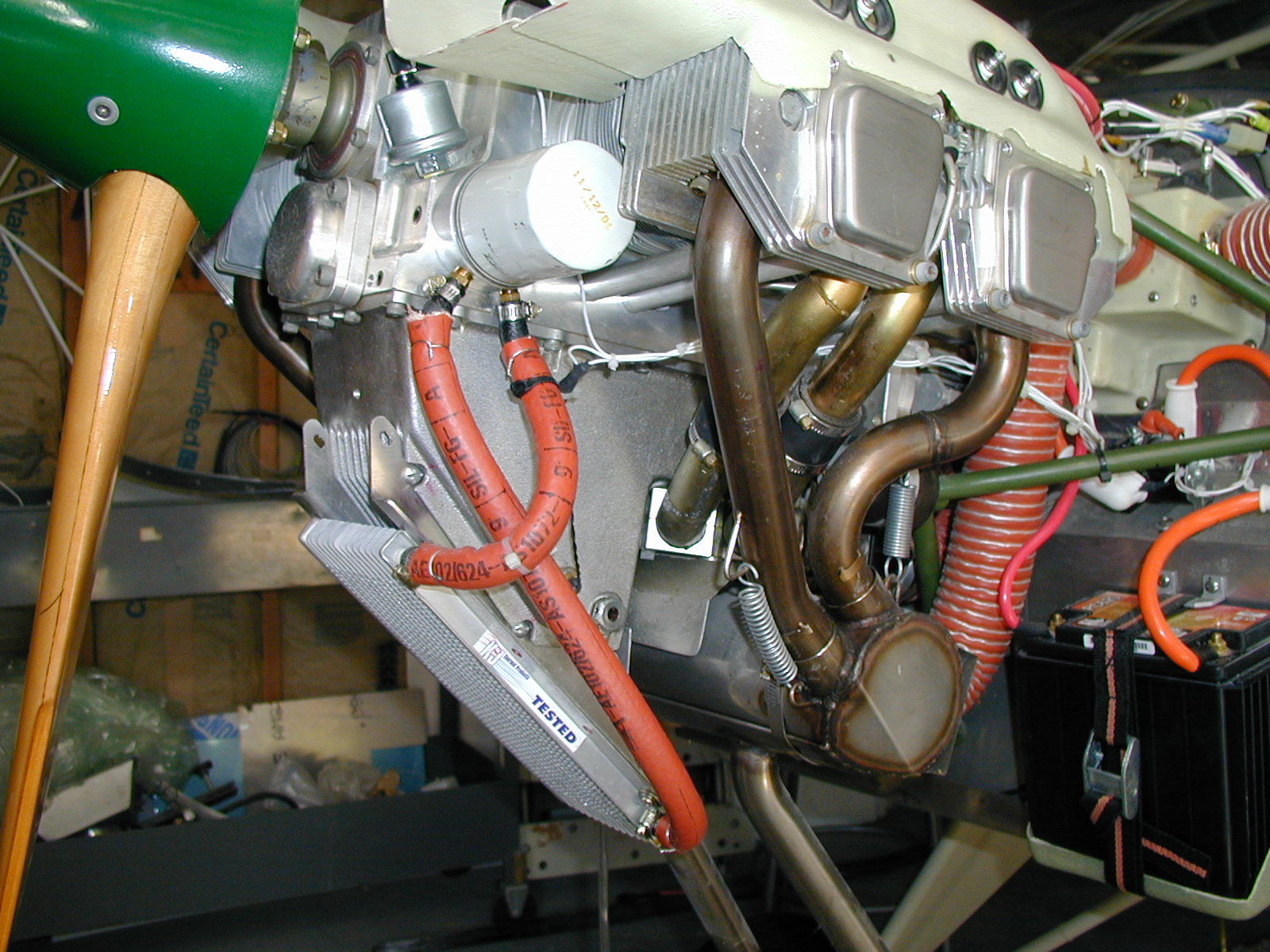

Can the oil pressure sending unit be located on the lower port. My new sending unit is larger diameter than the factory unti and won't fit in the regular location. Attached photos show standard location and the plug port I want to use.
Thanks in advance

wypaul
Joined: 08 Jun 2007
Posts: 24
PostPosted: Wed Sep 05, 2007 8:54 am    Post subject: Re: Oil Pressure Sending unit location Reply with quote
See the attached pix.
 Filesize:  297.38 KB
 Viewed:  1244 Time(s)
Paul Spackman
Q-2 Jabiru 3300
Andy Silvester
Posts: 18
Location: Marica, Rio de Janeiro, Brazil
PostPosted: Wed Sep 05, 2007 9:22 am    Post subject: Re: Oil Pressure Sending unit location Reply with quote
Perfect - Thanks, Paul. This is why the web-based format of this list is soooo much better than the YahooGroups offering!
Andy
