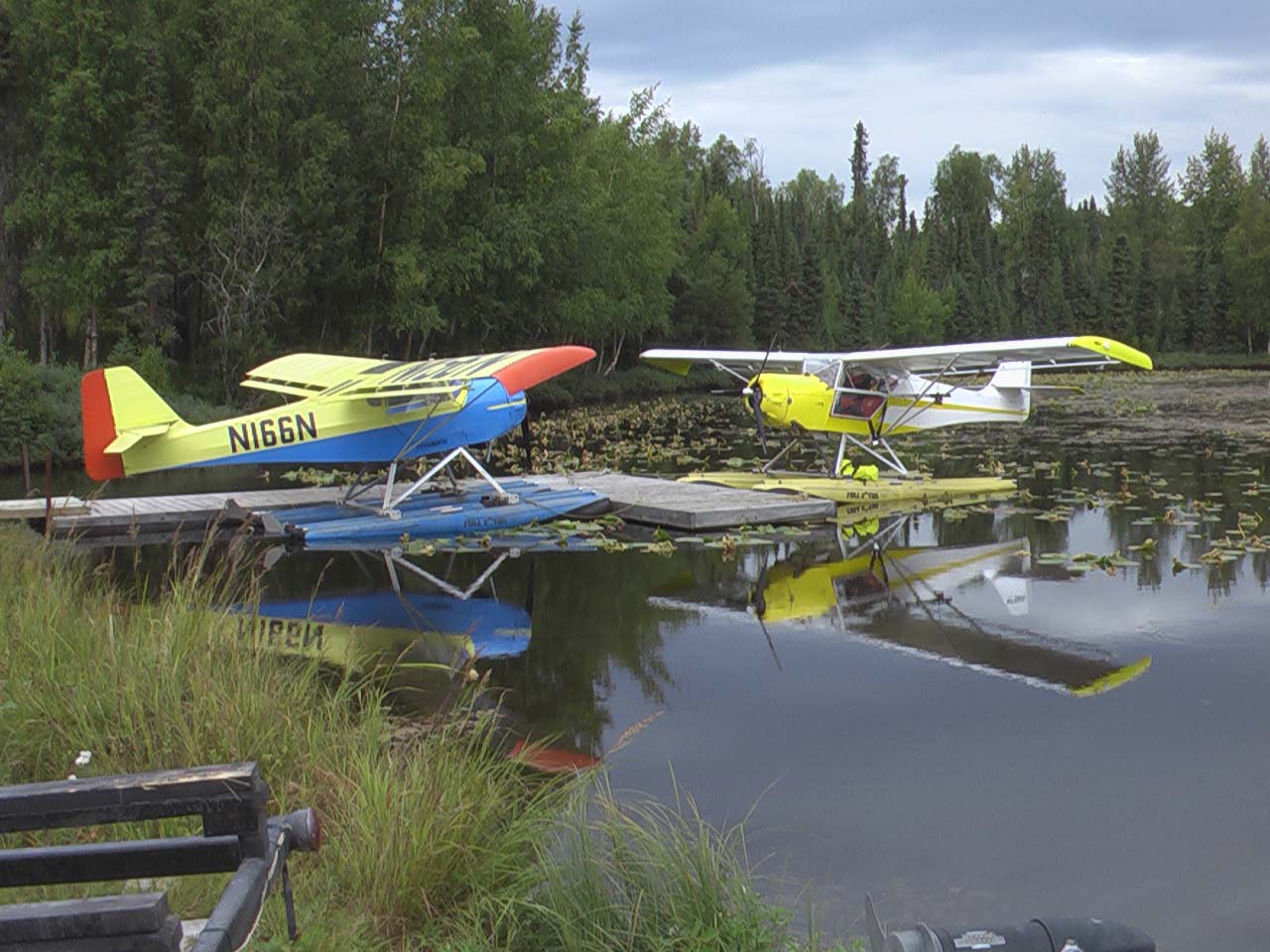

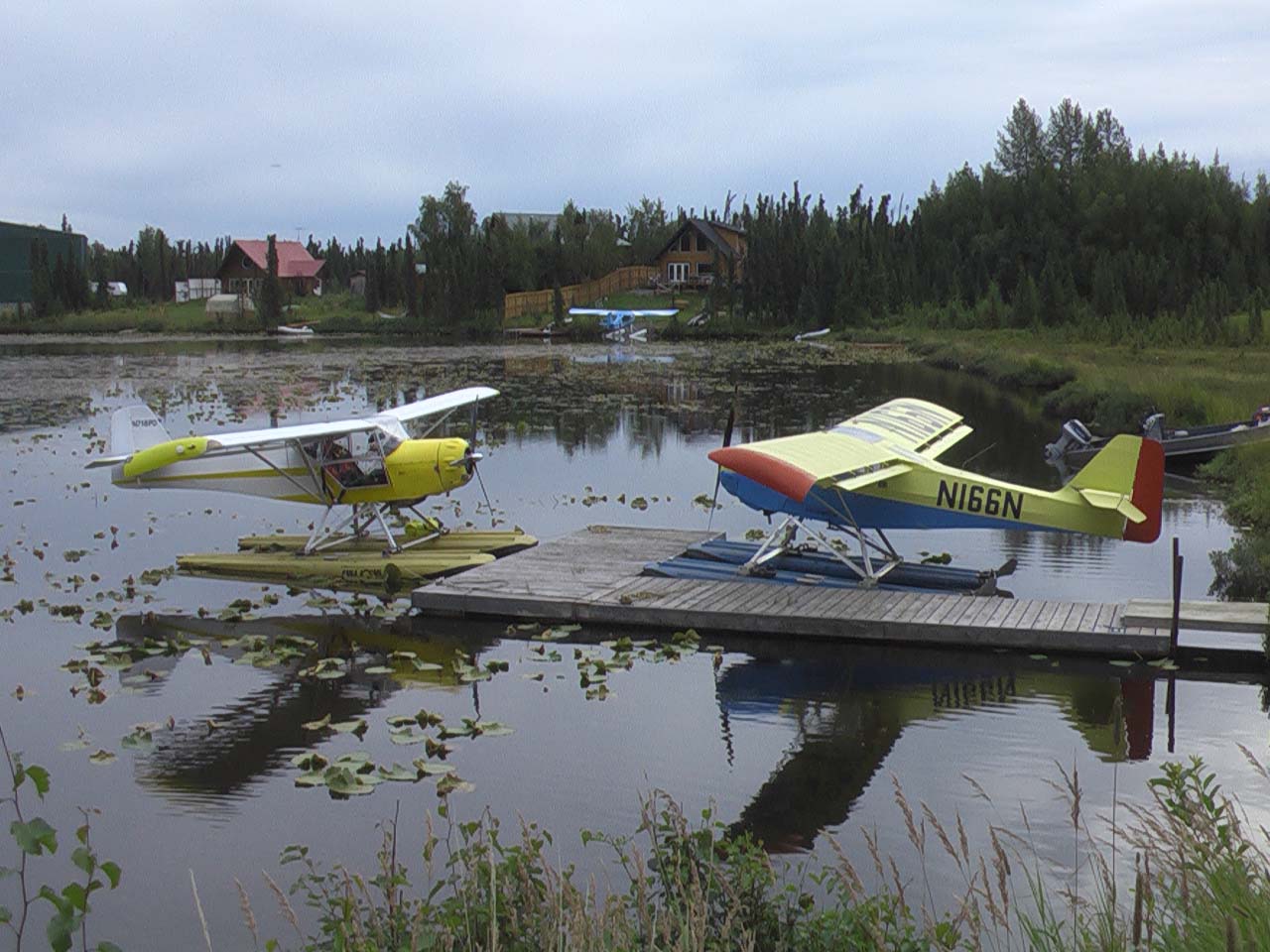

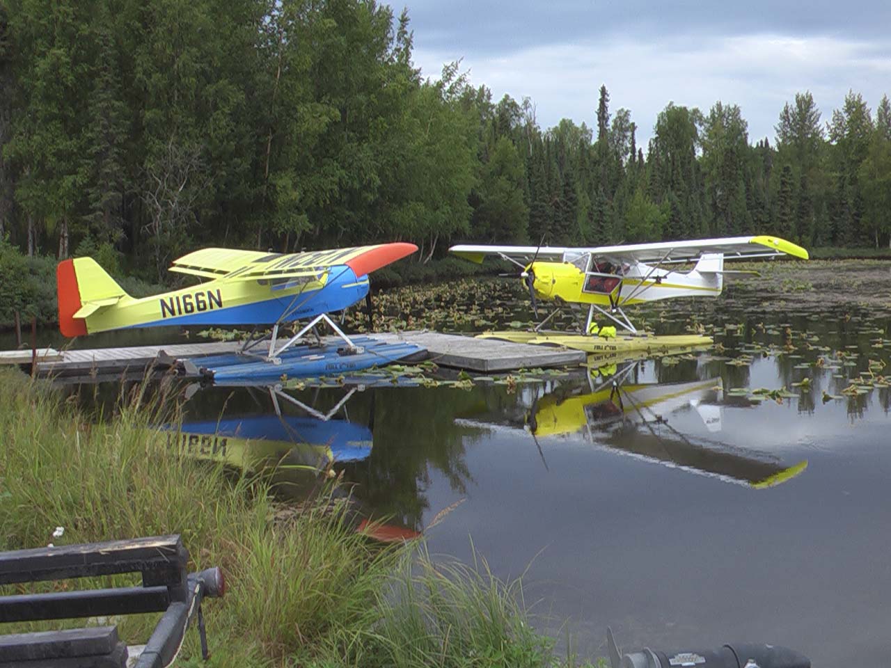

Attached are a few pics of a flight around Cook Inlet and Tuxidney Bay as well as one of us tied up at John Stoners dock. As you can see he has the original skystar rigging and placement. We are trying to talk him into moving the floats so he can get off the water at gross weight.
