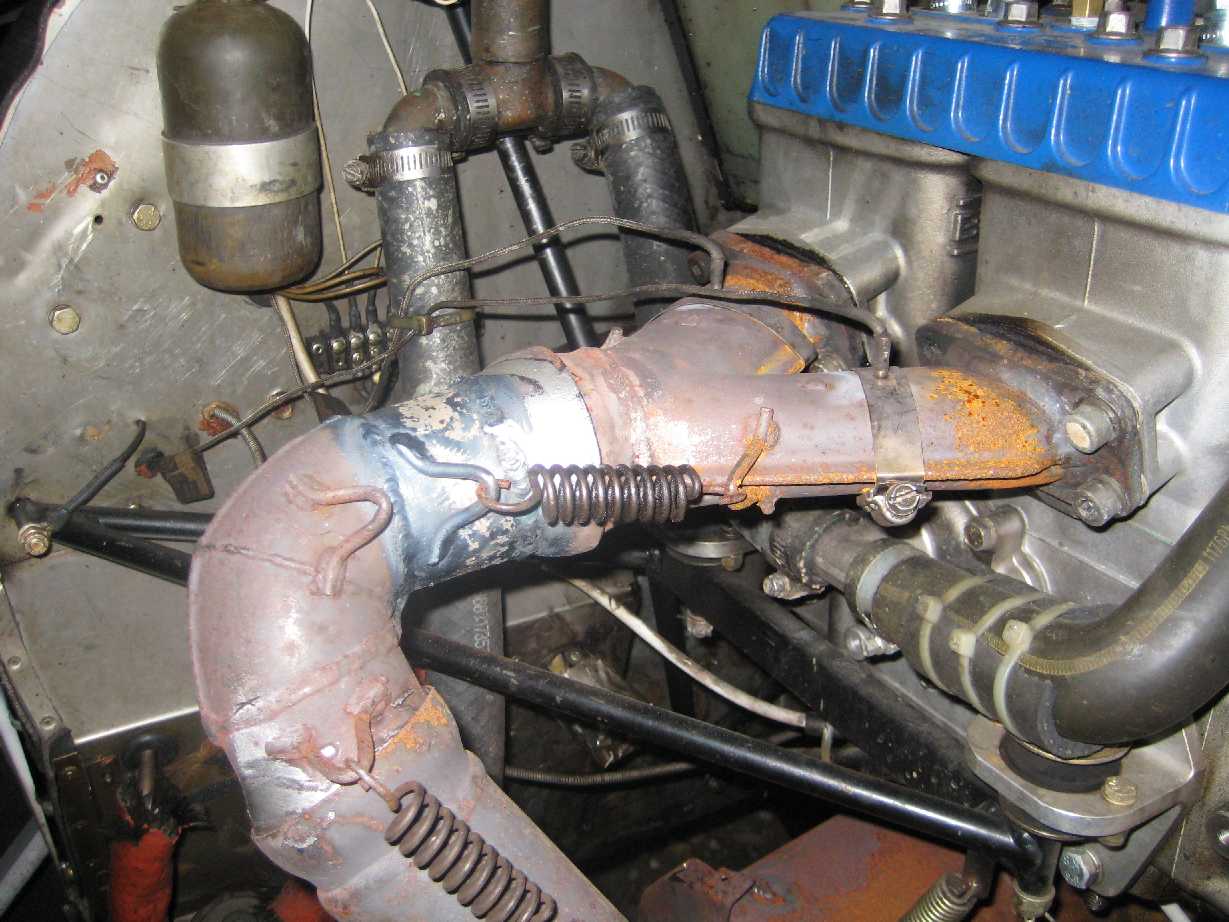

Well the Y pipe is what was cut I think at Skystar as well as the 90 Elbow but I added mine to the elbow. Your elbow will be near the cowl and might burn a hole in it but a air outlet could be added there or just a bump. The muffler will not longer be straight below the engine but on a little angle. I am sure there is a way to alter more but I have not spent the time on it yet.
Basically I just added 1 1/2 inches to the header directly onto the elbow on the top of it. I could have added to the y pipe but it seemed easier to do it this way.
Just out for a 1 hour flight with a friend , I have on the IVO medium right now and it worked well about 4 mph faster that without the exhaust mod.
Now all we need to do it put a different pipe on it and see another 5 or 10 hp Smile

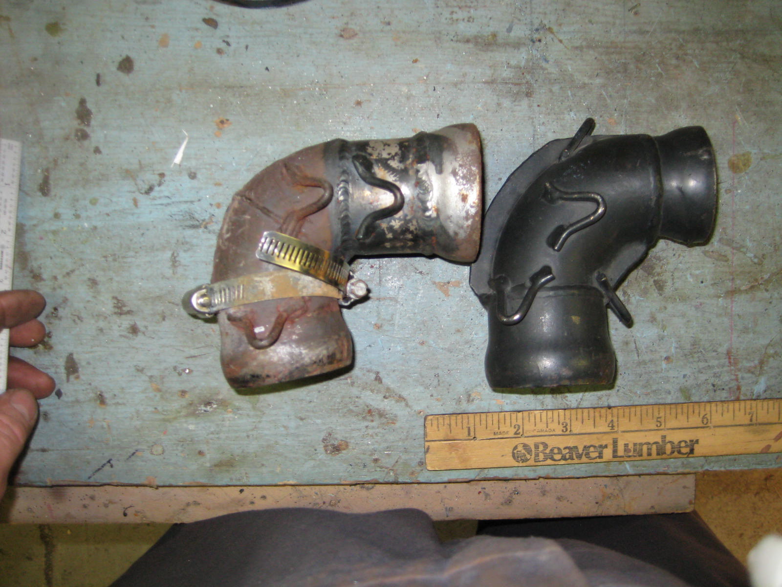

Further more to my last post on 582 exhaust mods.
I looked closer at that Elbow today that I modified and it looks like it was just a Elbow that was hand made rather than a Rotax Elbow. It you look at the pic you will see the Rotax radius is not as tight as this one. I will likely have to play around a bit more now and see what else can be had.
Has anyone else tried this yet ? I figure that I am still short from Rotax specs.

PostPosted: Fri Oct 12, 2007 1:59 pm    Post subject: Re: Exhaust parts 582 -- Extra HP from your 582 Reply with quote
Ok , I not sure if this topic getting a bit stretched or not , maybe a new topic if anyone thinks fit.
I finally got time to day to make a new elbow from scratch. It turned out about the same as the Skystar one except it a bit longer at bottom rather than at the top as I modified the last one and gained the HP.
I had to cut the tapered pipe where it joins onto the Rotax muffler and rotated it . length should be the same (+/- 1/8" ).
Wind today was 10 G 15 knots so it was hard to get a good handle on take off performance if better or not. I think i got about 50 to 70 more RPM static, really not a big deal. Got about 10 take offs and landings in at a few grass strips and worked ok.
Could not find a camera last 2 days around here - 3 kids plus a wife -- who knows where it is now. Will try to get some pics when I find it.
Overall I give this mod a thumbs up for performance gain.
