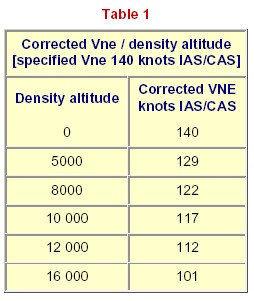

<?xml:namespace prefix="v" /><?xml:namespace prefix="o" /><![endif]--> At the risk of inciting a religious war, I found site backing up my previous claim that VNE is dependent on TAS not IAS nor CAS:
http://www.auf.asn.au/groundschool/flutter.html
rule of thumb #2.
For most light aircraft it is reasonable that only one Vne is specified in the Pilot's Operating Handbook or Flight Manual and that value may have been calculated for a 'normal' cruising altitude, say 5000 feet, rather than ISA mean sea level.
If uncertain about a particular aircraft multiply the (density) altitude, in 1000s of feet, by a factor of 1.5 to get the percentage DECREASE to apply to the specified Vne for a corrected Vne appropriate to the altitude. For example if altitude is 8000 feet and specified Vne is 100 knots then 8[000] × 1.5 = 12%. Corrected Vne = 88% of 100 = 88 knots IAS/CAS.
Table 1 is a normal calculation of corrected Vne, you can see that the difference between the 140 knots specified and the corrected Vne is significant and that it appears quite possible for turbocharged low drag aircraft to exceed corrected Vne in level flight at higher altitudes.
Vne as a maximum airspeed applies only for smooth atmospheric conditions and for gentle control movements; even vertical gusts associated with mild turbulence or control movements greater than say 25% travel will lead to some nasty surprises, if operating close to but below Vne. At such high speed the controls are very effective with a high possibility for over-control applying extreme loads to the structures and some aircraft control systems provide an inadequate feedback of the load being exerted i.e. a high load can be applied with a relatively low stick force..
Be aware: deliberately exceeding Vne is the realm of the test pilot – who always wears a parachute!

Wait a minute here. The quoted cite sounds authoritative, but U.S. Regs for production aircraft state that Vne must be marked on the ASI.
If we got enough of a turbocharger to get to like FL450, we could indicate down near stall at max cruise velocity attainable, and contrary to what they say, our ailerons won't be very effective at all. How can we possibly experience aileron flutter just above stall speed?
