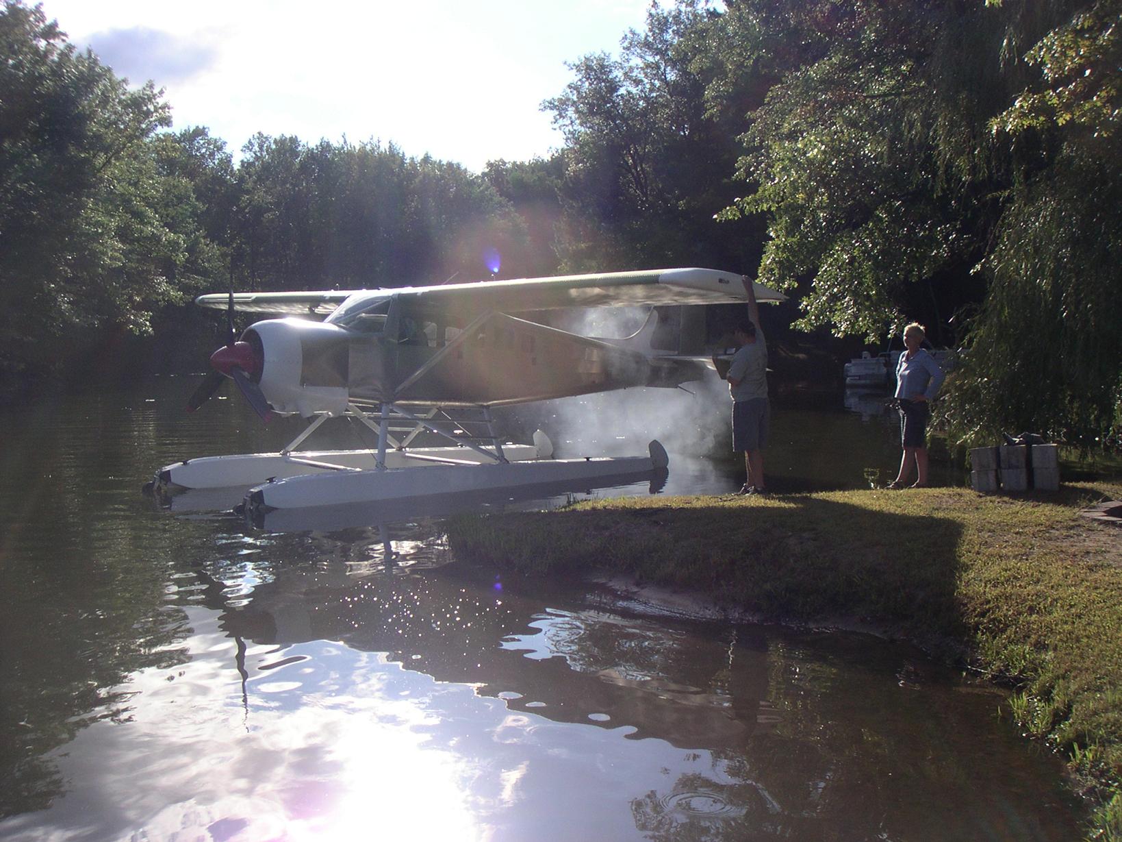

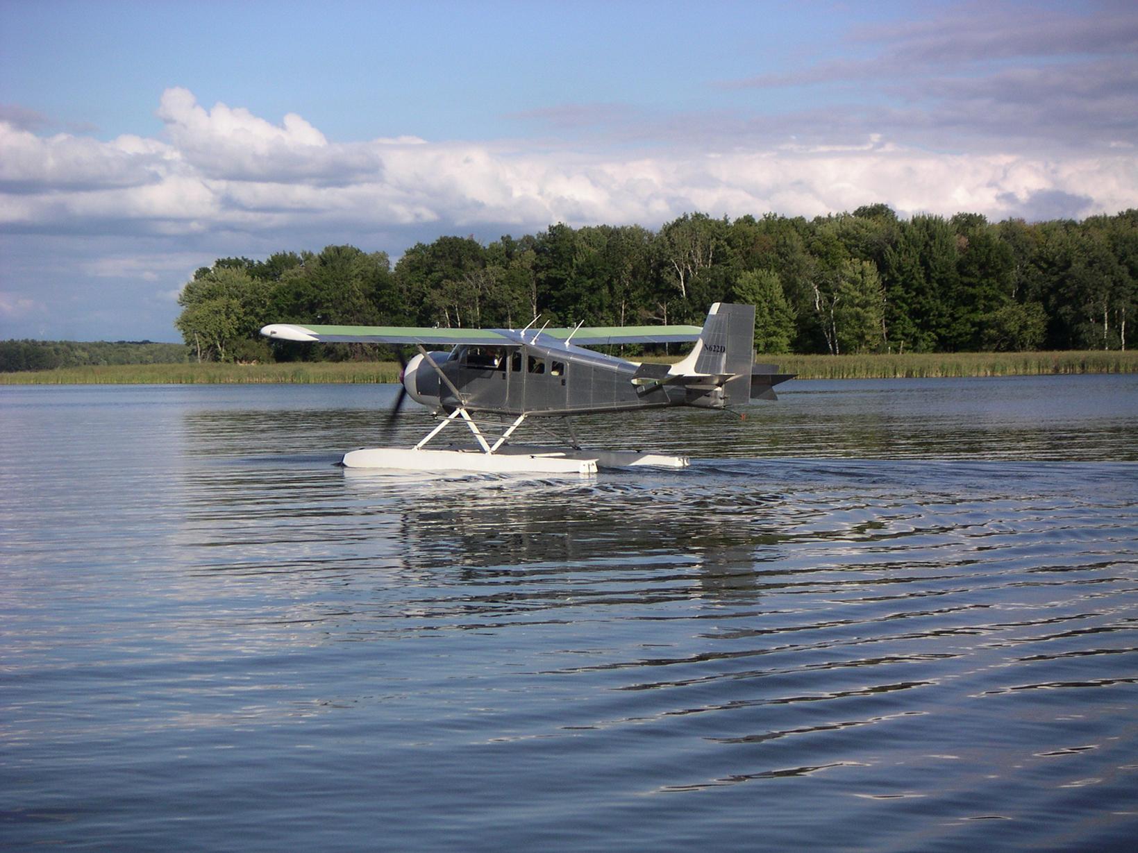

A friend of mine from upstate new york flies a Murphy Moose with the M14 on Aerocet amphibs and it has a reversing (MT?) prop on it. He loves the combination and has fun stopping the airplane and backing up. For sure not a necessary feature for a floatplane, but it sure comes in handy in close docking situations.
Here's a pic of Don's plane at my house this summer (he plans on painting it when he isn't so busy flying it and having fun...)
