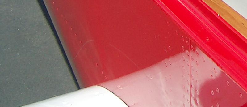

rv10(at)sinkrate.com
PostPosted: Fri Oct 12, 2007 7:05 am    Post subject: Call for data (used to be RE: Dan's H6Turbo numbers) Reply with quote
Dan,
I noticed something interesting on Van's personal RV-10 at the homecoming
this year in Independence, OR. He must have flown through some moisture on
the way cause there were some small water spots on the plane.
The fuselage had a distinct line of grime on it about 6 or 8 inches above
the wing root in the exact shape of the wing itself. This gives you a
pretty good indication of the way air flows in that area. I don't know
anything about aerodynamics to comment as to what it means but I thought you
might be interested in this.
Attached is a snippet from a picture I took of Van's plane with the faint
line on it.
-Ben
40579
 Filesize:  25.78 KB
 Viewed:  246 Time(s)
LloydDR(at)wernerco.com
PostPosted: Fri Oct 12, 2007 7:36 am    Post subject: Call for data (used to be RE: Dan's H6Turbo numbers) Reply with quote
Nice catch this would be interesting to tuft these areas and see what is
going on with it.
THX for the pic
Dan
