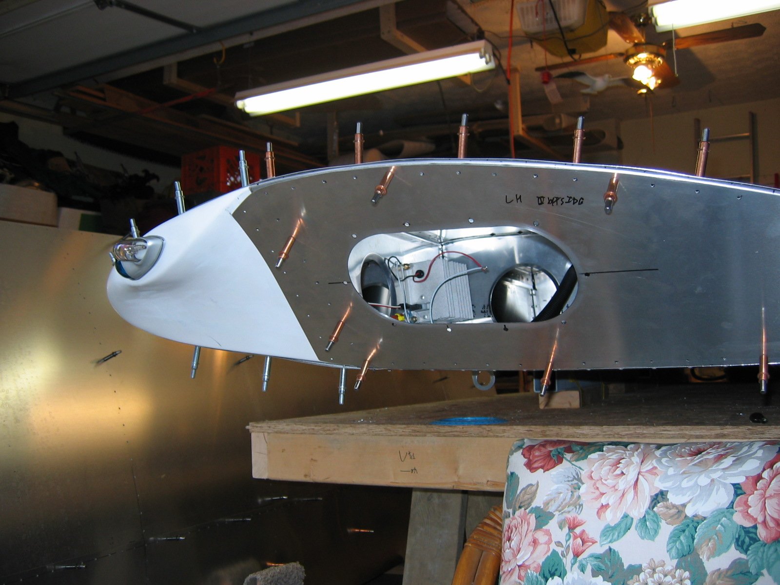

The only supplies you will need are MS21075L3 nut plates, MS20426AD3-2 rivets (2 per nut plate) and a screw AN525-10R7 per nut plate. Tools will be a drill and snips to cut the holes needed. You do not need to dimple the rivet heads if you do not want. I have countersunk mine. You can use a hammer and flat punch to set the rivets if you do not have a rivet gun. Here is a picture of the hole in my XL wing tip showing the strobe pack inside. It also makes a good inspection hole.

leinad
Joined: 19 Sep 2006 Posts: 283 Location: Central Virginia
Posted: Sun Oct 14, 2007 5:34 pm Post subject: Re: access panels |
Dave,
Good job and great picture. I do have a question though. Isn't that the wrong color nav light? Left wing should be red I think.
Dan
| DaveG601XL wrote: | Carlos,
Good Luck, |
| | - The Matronics Zenith-List Email Forum - | | | Use the List Feature Navigator to browse the many List utilities available such as the Email Subscriptions page, Archive Search & Download, 7-Day Browse, Chat, FAQ, Photoshare, and much more:
_________________ Scratch building XL with Corvair Engine |
| Back to top |
DaveG601XL
Joined: 27 Oct 2006 Posts: 351 Location: Cincinnati, Oh
Posted: Mon Oct 15, 2007 3:08 am Post subject: Re: access panels |
Well Dan, you got me on that one. In my defense, I only grabbed the closest light to me and used it as the guinea pig on both sides for fit-ups. The lights have not been back in since and await patiently in the box.
One more thing, the hole in the outer panel, as it turns out, is a great grip point for lifting the wing. It has proved to be strong enough to use as a hand hold without distorting. I upped the tip skin piece to .025 (kit is .016).
