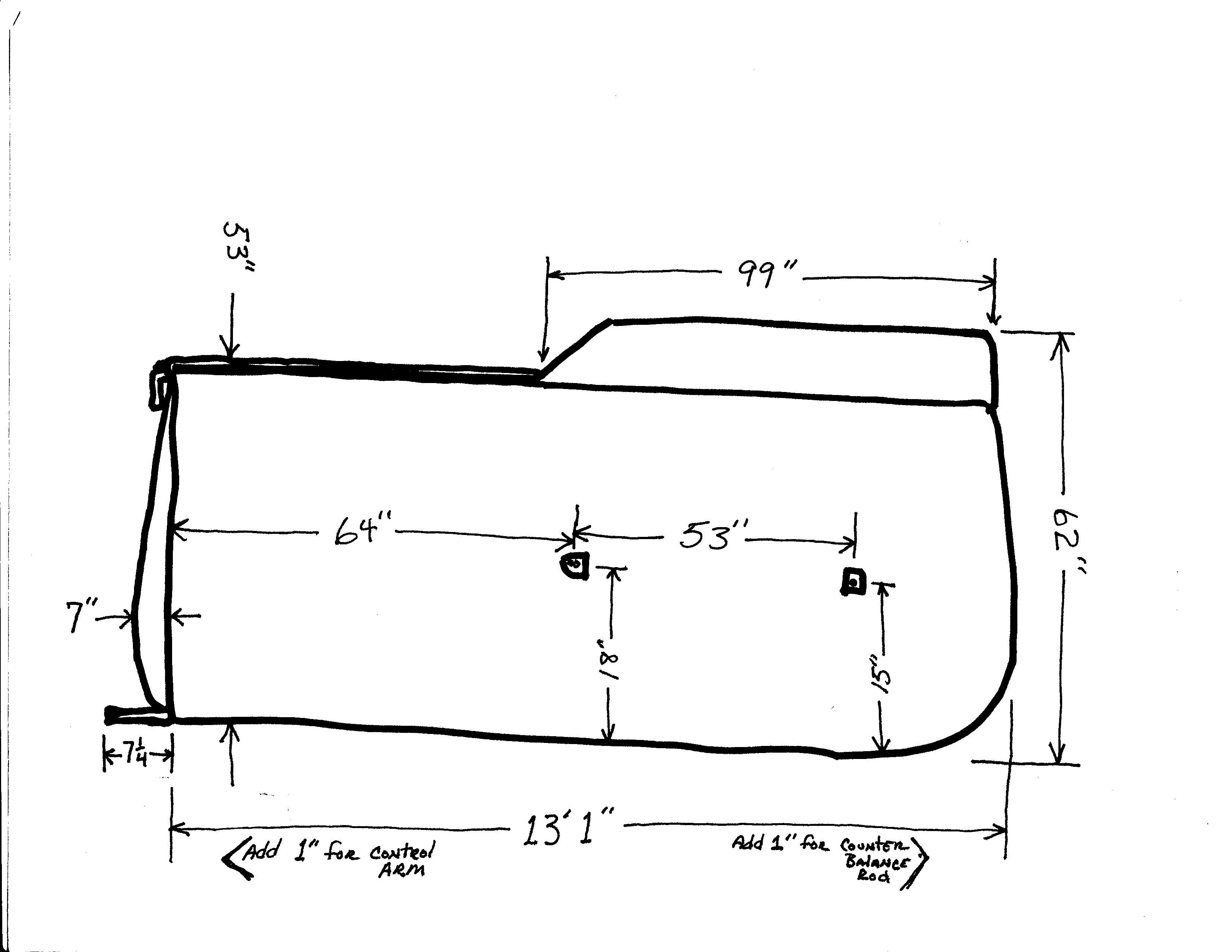

Hi Bob,
The cord lenght is a Combination between the wing and the ailerons ( 61" ).... I don't think "that" is the number your looking for...
Your looking for the dimensions of the wing & Aileron....
My Wings are in the Garage....If you need the measurements...
I'll get them...
Gotta Fly...
Mike & "Jaz" in MN
[quote="Bob Dresden"] What I need to know is the total chord w/ailerons so as to modify the rack accordingly.
OK,
I'm Back with the dimensions..... ( attachment )
This should cover Everything that you need....( and more )
My wing and ailerons are "stock"........( except bracing )
Gotta Fly...
Mike & "Jaz" in MN
modify
I believe the http://www.tnkolbaircraft.com/ Site says that it is 64
inches, however mine measures 66 inches. Good luck.
Larry C

PostPosted: Mon Oct 22, 2007 8:48 am    Post subject: Lurker on the loose Reply with quote
Kolbers, Many thanks to the replies on wing size. The info is just what I need. I'm still debating whether to pull the wings, it's set up to go down the road backwards. My concern is crosswinds and truck turbulence at 100+mph going down the road. All mountainous 2 lane w/limited shoulders. Skinny suckers. Now I'm curious as to how well they follow. Is there experience on the list with carting an open trailer in the wind? Appreciate all comments. And, by the way, this list is GREAT! Just reading about my favorite airplane has gotten me through some rough times. I always knew I'd have one someday. Never let go of your dream!

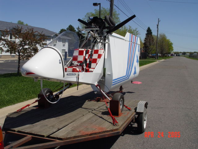

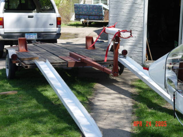

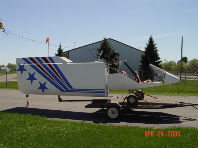

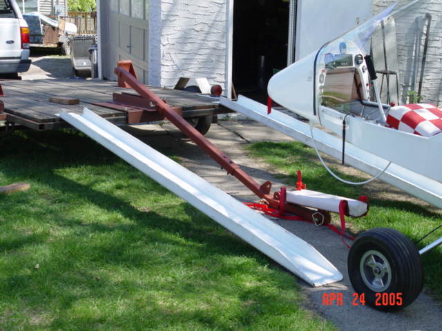

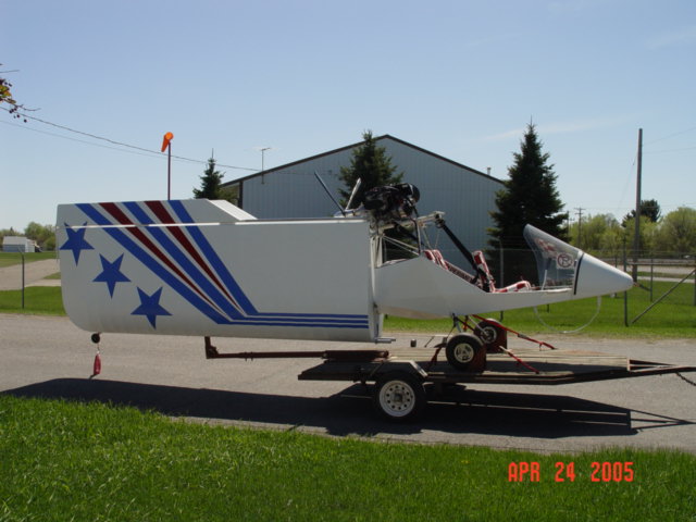

planecrazzzy
PostPosted: Mon Oct 22, 2007 2:29 pm    Post subject: Re: Lurker on the loose Reply with quote
Pictures...
I can Haul Azz with the plane on the trailer this way.....
Like a fish headed up stream.
and the way the trailer and "arm" are set up....it's a gentle ride
Gotta Fly...
Mike & "Jaz" in MN

gaman(at)att.net
PostPosted: Mon Oct 22, 2007 3:17 pm    Post subject: Lurker on the loose Reply with quote
I anchor my Firestar in three places.Straps over the tires and a strap over the boom tube at the support.Long trips I nail two short 2x4 next to the tires so they cant slide side to side.1100 miles to Fla and back for 4 years.No damage ever.

PostPosted: Tue Oct 23, 2007 11:18 am    Post subject: Re: Lurker on the loose Reply with quote
Mike,
Thats a great setup you have made for hauling your Kolb.
I'll be making something similar out of my spare single Seadoo trailer.
Secured at the tires and supported along the boom with a bracket and straps is ideal.....Headfirst of course!
