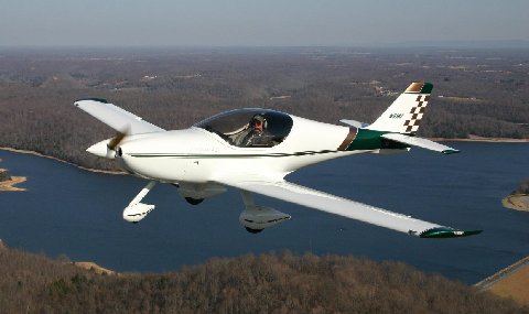

Don't know what type of aircraft you are building, so this might not help, but I have a 3300 in my highly modified Esqual and no mufflers are installed. Each side is a three into one straight exhaust pipe. I use two small heat muffs, one for carb heat and one for cabin heat that fit over the straight pipe section on each side. The sound is not much louder that a 3300 with a muffler, but it does have more of a "deeper" or "throaty" sound. I really like it. The heat muffs came from - http://robbinswings.com/

I don't know for sure that I have an increase of power with no muffler (have not flown it with a muffler), but based on many years hot roding cars and then a Pitts Special with straight pipes, I think it helps. Any increase in power will depend on the type of muffler (or mufflers) you take off, but less back pressure generally will result in an increase of power. Besides, it sounds better to me. People still say how quiet the jab 3300 is, especially those use to hearing Lycs. and Continentals. I wish it were louder
The 3300 set up on my airplane must work, it has been trouble free for 380 hours. Come mid December it will have been flying for 2 years and I should have at least 400 hours on it by then.

That is a great shot of the Esqual .neat.
I am test flying my J3300 Quickie with fuel injection. I have given details on the list. I am getting over 170KTS CAS at this stage but there is another Quickie in Wisconsin (Paul Spackman) getting 180KTS TAS with the Bing carb. Early days yet I have only 25HRS on the engine and the prop is probably a little too big. 55”X72”pitch Sterba. Paul is getting more rpm with a 54X72 Sensenich
