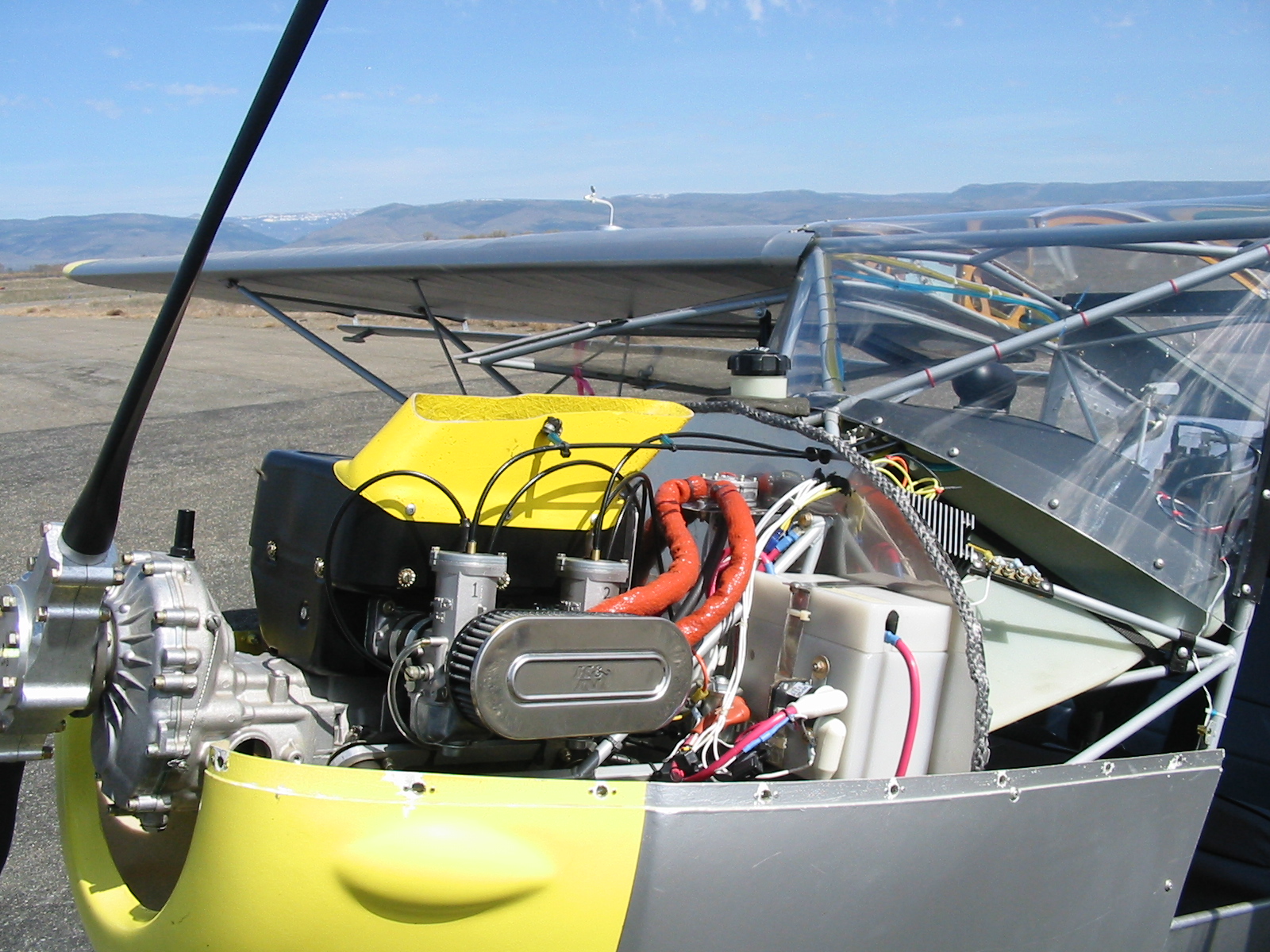

are you flying a 4 with a 503? how much douse the plane weigh?� my mod 2 is 538 lb. my only open door flight was when the passenger door opening on take off.
Malcolm, yes a 503 in a classic 4. See pictures attached. It weighs 546 and I weigh 160.
If you want to breeze and slip the 'fox take the doors off first... It only takes a minute or so.
Noel, I will probably take the doors off in the summer. When the doors are on I would like to open mine to take pictures.

Fox5flyer
PostPosted: Sun Oct 28, 2007 3:00 am    Post subject: Doors open Reply with quote
Nice install Tom. Looks great!
