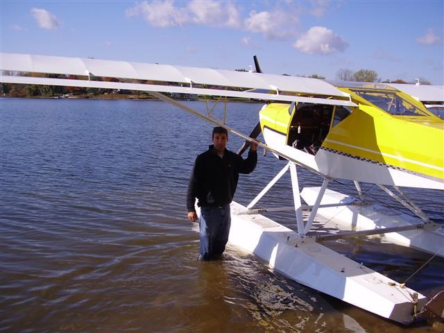

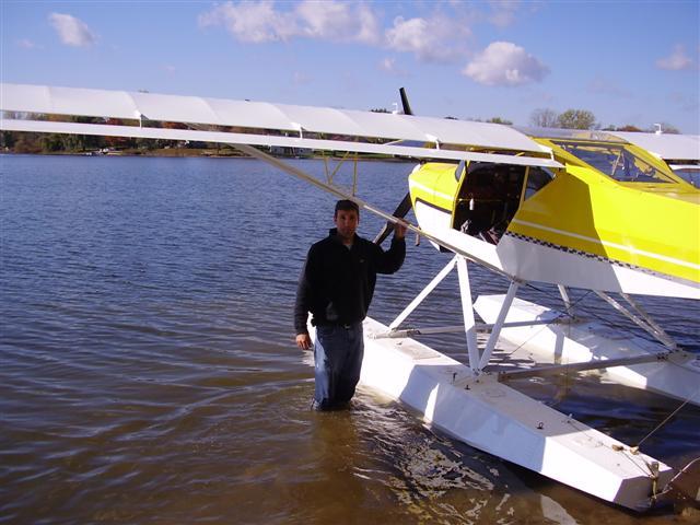

Close to 20 hrs on my kitfox now. Seems to fly great and I'm having a ball. I'll try to post some pictures soon as well as more video. This is my first attempt.

[img]cid:001101c81c2d$35aa7a10$62e13818(at)D569C821[/img]

I like the way your plane floats nice and high! Judging by the way it is sitting in the water the CG looks as far forward as you would want with no weight in it. ( perfect )
looks as far forward as you would want with no weight in it........
The CG seems to be good for flight per weight and balance but when I'm on the water I sometimes get water
splashing over the bows. Not sure if the bow wave is unusually large because of the open cavity for the
nose gear or what. This winter I will move the floats ahead 2"-3" and see if that helps. That should put
my cg right at the forward edge with 170 lbs pilot, everything added from there moves the cg rearward.
Thanks for everyones kind comments.

What model Czech floats are those?
Can you share more photo’s of the floats with us?

Thanks Greg, They are model 1650A's. Not very common on Kitfox models I assume it is because of the weight, about 320 lbs. I'll have the airplane on my beach all weekend so pictures should be coming soon!
