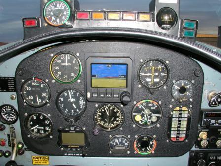

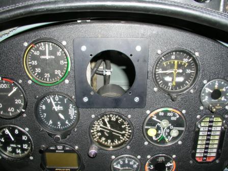

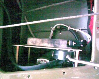

PostPosted: Sat Nov 03, 2007 1:14 pm    Post subject: Re: Best EFIS in a Yak/CJ Reply with quote
Here are a couple of pictures. You'll notice the magnetometer mounting bracket also has a VOR antenna mounted to the bottom of it. The set up makes for a very crowded tail but has worked well thus far. Excuse the shameless plug but I offer a couple of the parts as kits on my website. Feel free to give it a look at
www.thedefiantcompany.com.

PostPosted: Sat Nov 03, 2007 5:42 pm    Post subject: Re: Best EFIS in a Yak/CJ Reply with quote
I personally like the BMA EFIS/Sport. It would likely requires a new panel to be built but it will give you a ton of capability. You'd have to see if it will fit in a 52. BMA does have the EFIS Two as well. Both of these units give you nice IFR capability, moving map, and you can add engine monitoring.
Craig

PostPosted: Sat Nov 03, 2007 7:39 pm    Post subject: Best EFIS in a Yak/CJ Reply with quote
I was looking at the EFIS Sport and based in the website information it
looked to me like if you removed the RMI and the ADI the EFIS would fit in
the hole for the RMI. I never had a chance to test that theory though.

viperdoc(at)mindspring.co
PostPosted: Thu Nov 08, 2007 11:15 am    Post subject: Best EFIS in a Yak/CJ Reply with quote
Pull the ADI out and it fits perfect. Will have to make a back plate to bolt
it to your panel though. Postive side is you lose the inverter!
Doc
