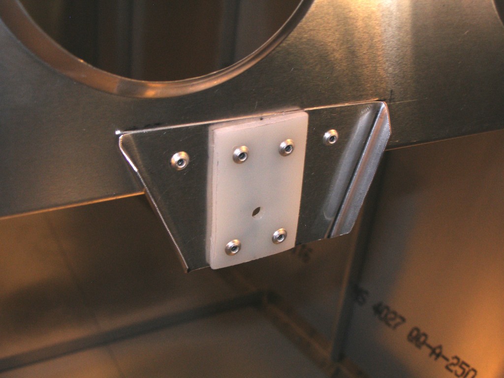

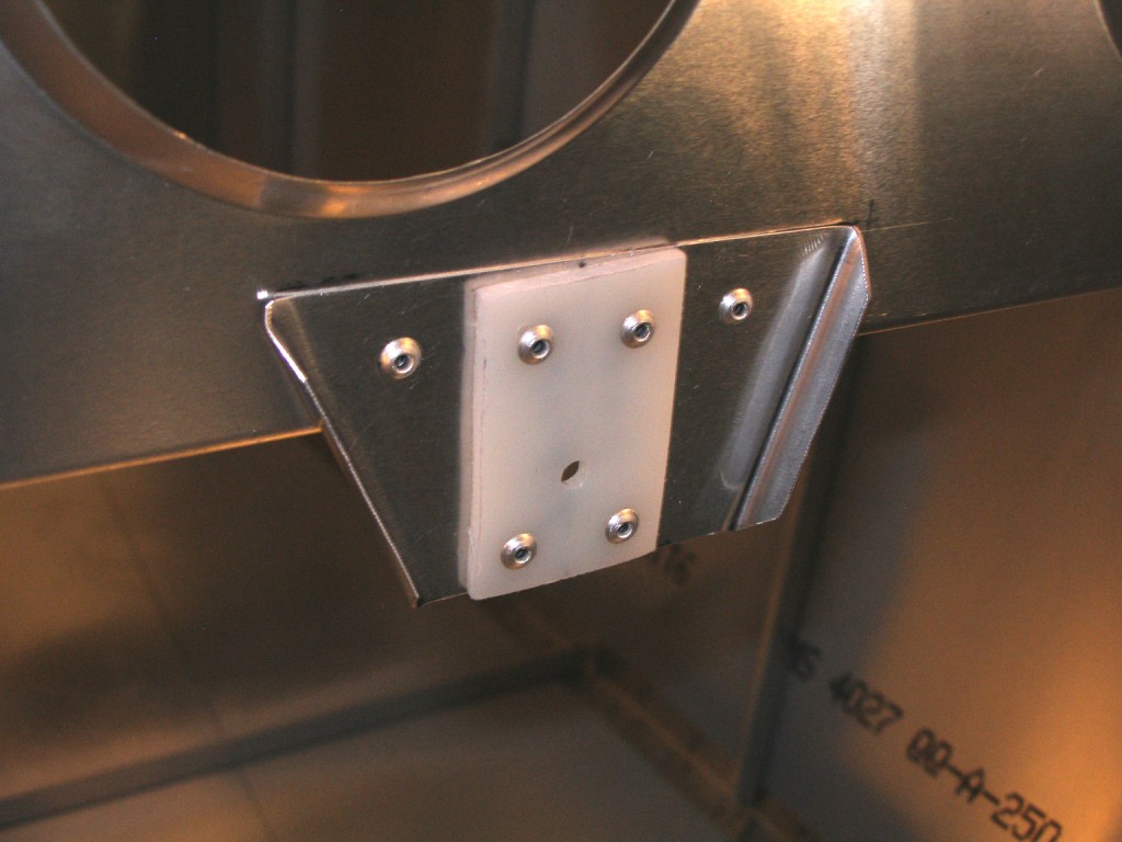

I don't think that rigging is addressed in the photo guides. You just have to follow what is shown on 6-B-23.
I installed the vertical angle shown on 6-B-22.
I also installed a doubler for the elevator fairlead that attaches to bulkhead 6B12-3 (see photo) because others have reported that this one is prone to break off.
Jay in Dallas 601XL N2630J
