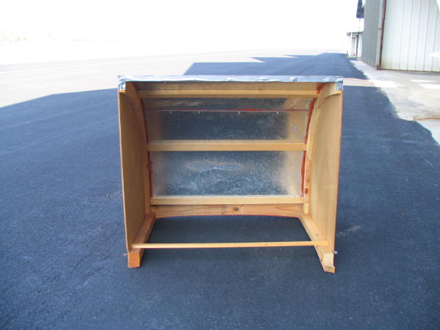

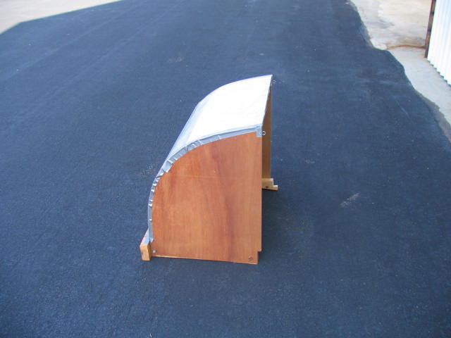

When I overhauled my TSIO-520 I made a hood so I could do an on aircraft engine run-in, check engine parameters and setup the FI pressures. Setting up the pressures is an involved process and time consuming.
I made a hood so the engine got proper air flow past the cylinder. In my case, I made it out of plywood and metal flashing from Home Depot. I then set it on my engine baffles and tied it to the engine. It worked pretty well. I followed an article I found on the subject of ground running an engine.
I will take a picture tomorrow and see if I can post it.

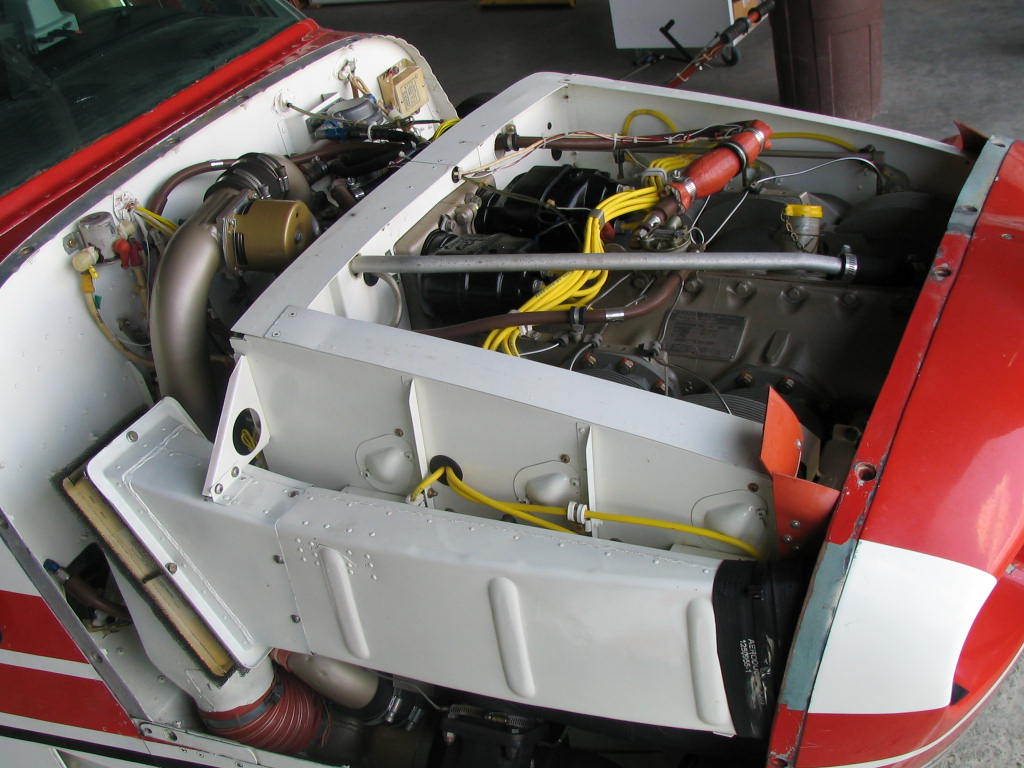

RV10 4JF
Joined: 30 Nov 2007
Posts: 7
PostPosted: Sat Dec 01, 2007 4:33 pm    Post subject: Re: Engine Choices Reply with quote
Attached are a couple of pictures of my homemade engine hood. Plywood sides, 1x and 2x structural wood for the frame and metal flashing. Construction adhesive was used on all mating surfaces, roofing nails for the metal, duck tape and high temp RTV to seal the joints. Simple but effective. It must be securely attached to the engine. I set it on my engine baffles and did my engine run in prior to the engine break in. The article I followed recommends at least ½ distance from spinner to tip of prop.
