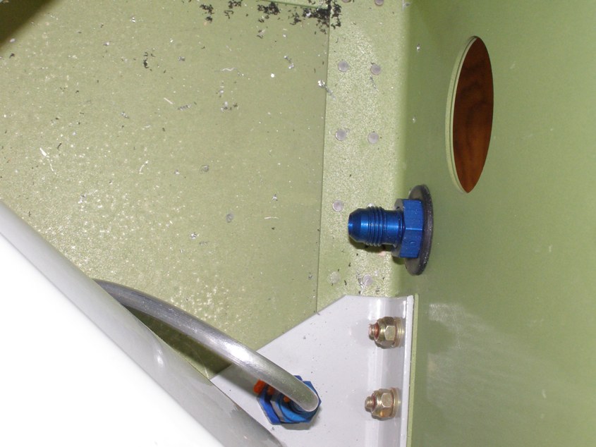

Today I went to make the fuel lines that run under the front seats and I've decided my previous approach using bulkhead fittings at the tunnel and at the wing root would be a mistake. Earlier in the week I posted some pictures on our web site of machined aluminum bushings I made to allow the use of bulkhead style fittings at the tunnel and at the wing root. Well, as I got into the tube installation I found that tunnel area was a lot stiffer than I really appreciated and I became increasingly concerned about the straight run of tubing issue between two stiff bulkheads. However, I still wanted to use the bulkhead fittings at the tunnel so I looked into what options I had at the wing root. I found that I could push a bulkhead fitting thru the rubber grommet that comes with the kit. So this is what I've decided to use. I put the grommet in the fuselage wall first and then ran a 1/2" drill bit thru the opening, then installed the bulkhead fitting. Now there is compliance in this of the fuel line. Comments appreciated.

rnewman(at)tcwtech.com Guest
Posted: Sun Dec 09, 2007 3:52 am Post subject: Fuel bushing re-think |
Bill, I think that what you suggested is the most straight forward way to run the lines (from the tunnel to the wing) except that then there is a stub of aluminum tubing sticking out of the side of the fuselage just asking to get bent over and ruined up till the wings are attached. I know I would end up wrecking it. So that drove my decision to have a bulkhead ftg at the wing root.

Bob,
The beauty of just having a fitting at the tunnel and going straight from there to the tank is that you can fit the line more or less, and then remove it until you are ready to install the wing. Then it isn't in the way and in danger of being messed up. That is one of the reasons I don't like the plans version because once you get the line fit and run inside the tunnel, it is almost impossible to remove. The one bulkhead fitting solves this problem.

Jesse, I didn't install a bulkhead fitting at the tunnel. I went with
the grommet, but I did terminate the fuel line midway under the seat so
that it should be a little easier to attach the final section to the
wing. (I'll let you know how that works in a couple of days)

MauleDriver wrote: [quote] We are definitely on the same page on that point...if I can't just figure out how to keep those steps from wrecking my shins. (I know there are solutions - but I'm having some shin-kill stickers made up).
Thanks Bob - just wanted to check.
Bill (do not archive) Watson
Bob-tcw wrote: | Quote: | Bill, I think that what you suggested is the most straight forward way to run the lines (from the tunnel to the wing) except that then there is a stub of aluminum tubing sticking out of the side of the fuselage just asking to get bent over and ruined up till the wings are attached. I know I would end up wrecking it. So that drove my decision to have a bulkhead ftg at the wing root.
